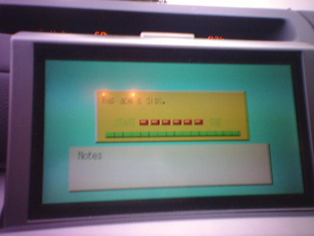

I just got the Copy of the Navi DVD from JeremyP11. I put in the firmware, and it goes through, then it shows this screen and I put in the Navi DVD and it doesnt do anything and just stays on this screen, anyone have this problem and know what to do?

turn it off and then back on (reboot it) and put in the DVD.
