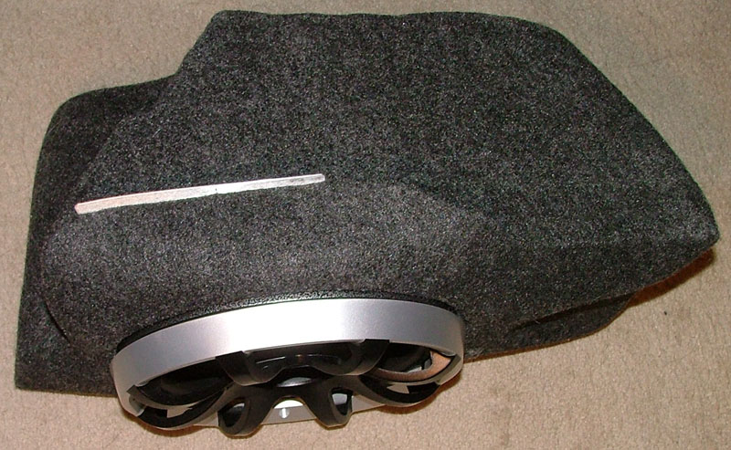

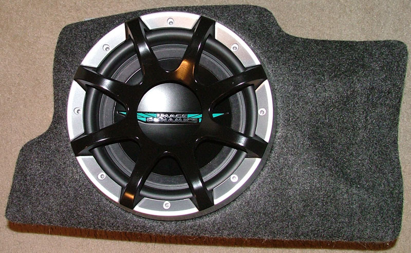

Just finished installing an Image Dynamics IDMAX10 v3 D2 in a 4080 enclosure. Needed to add 1.5" of spacer rings to accommodate the huge magnet assembly of the IDMAX. Just wanted to share a couple of tips. The 4080 box easily has room for a 3/4" spacer ring to add additional depth and still use the provided flush-mount grille. I used a painted Polk Audio Momo grille for this application (kept color scheme of Volk GT-7s). Thanks for the group buy 4080. The enclosure is top notch!
