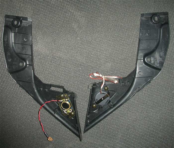

Originally Posted by tantura
I was just wondering if anyone had installed tweeters in a non stock location? I was thinking of using the defrost (I guess) vents to install the DLS Nobeluim tweets. I would really like to keep the stock look. Any insight would be appreciated! Thanks!
Why non-stock location if you want the stock look?
You'll get a better sound stage by keeping them up in the cabin.

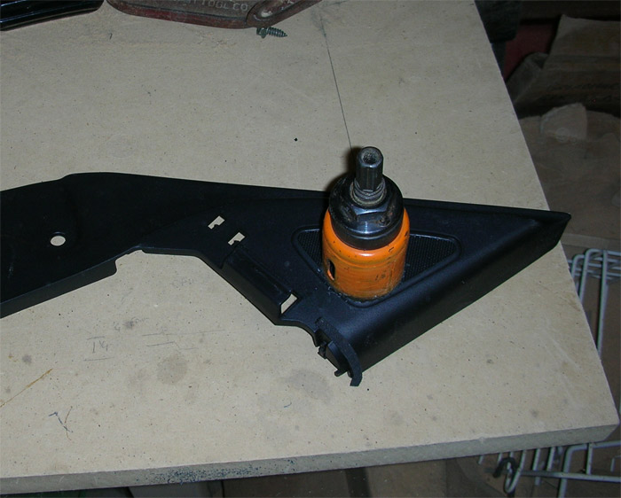

Here's what I did to cut my Focals into the OEM location.
Just used a hole saw by hand to cut the plastic.
Attached Thumbnails Tweeter Install-tweet1.jpg   Tweeter Install-tweet2.jpg   Tweeter Install-tweet3.jpg

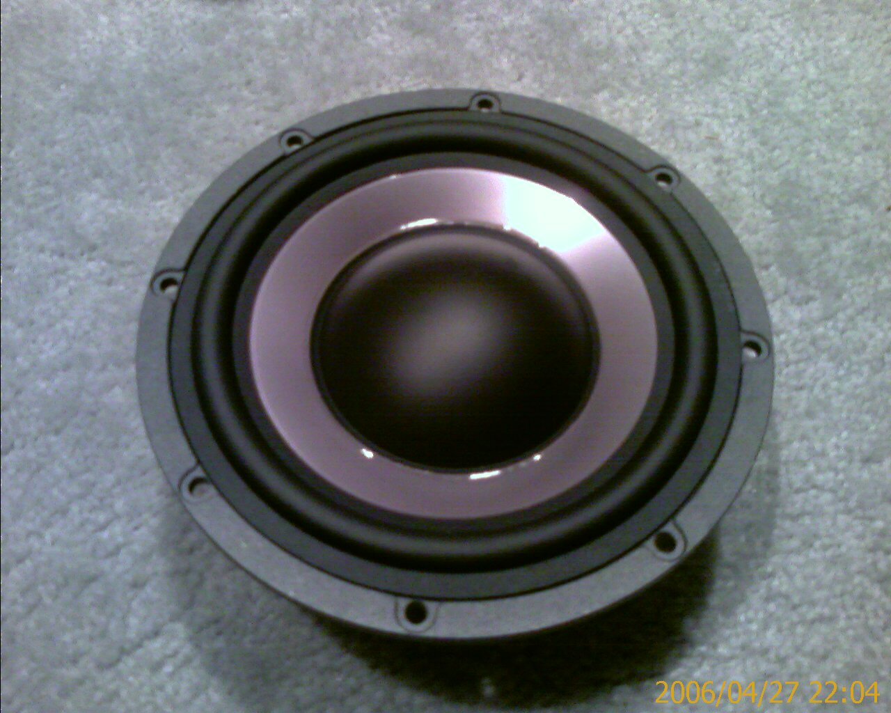

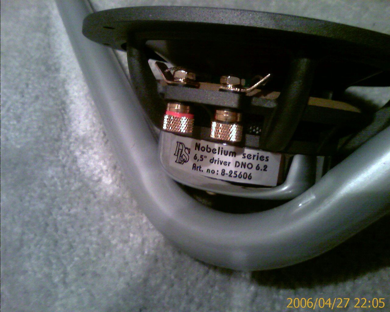

Ok, so my tweeters came in and they are even bigger than I thought... See them next to the UP6 tweeters!

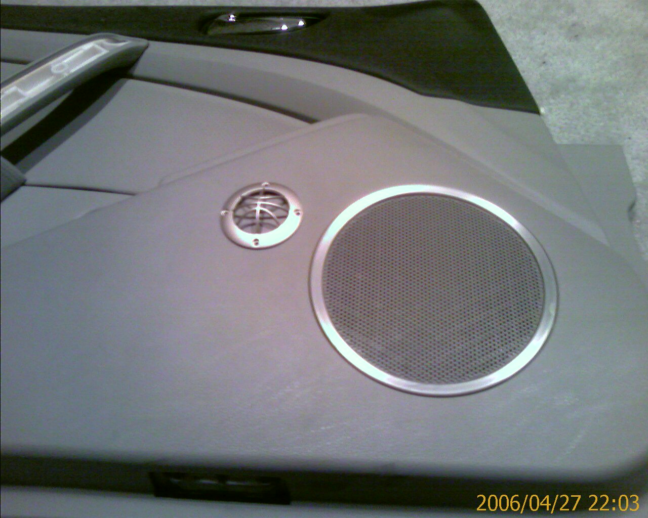

However the grill will match the stock trim. Does the fitting below look right? semi-stock perhaps.
As far as imagin goes, will it make a difference having them installed lower on the kick panels or next to the 6.5" and should I consider adding/keeping the stock tweeters in addition to the Nobeluim tweeters? Thoughts and insight are appreciated!
That actually looks pretty good right there next to the stock speaker. Looks pretty factory.
Only real advantage I see in putting it in the kick panels is that you'll have one less wire to run through the door which is a PITA. Plus, by putting it on the kicks, you'll place more distance between you and the tweets and thus making the difference in the distance between you and the left and right tweets smaller which would help with sound.
But the door panel mounting looks really good!
