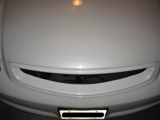

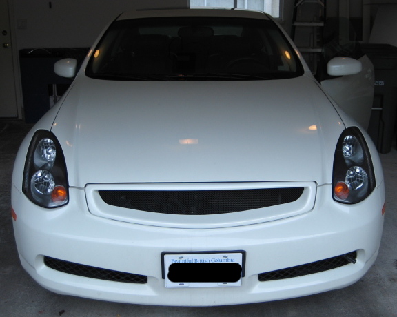

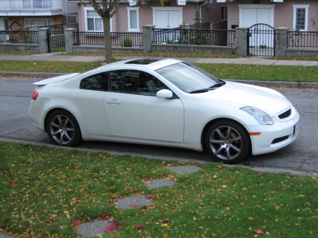

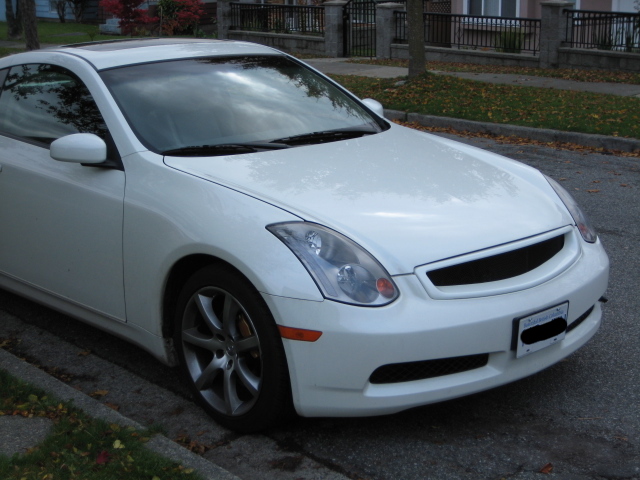

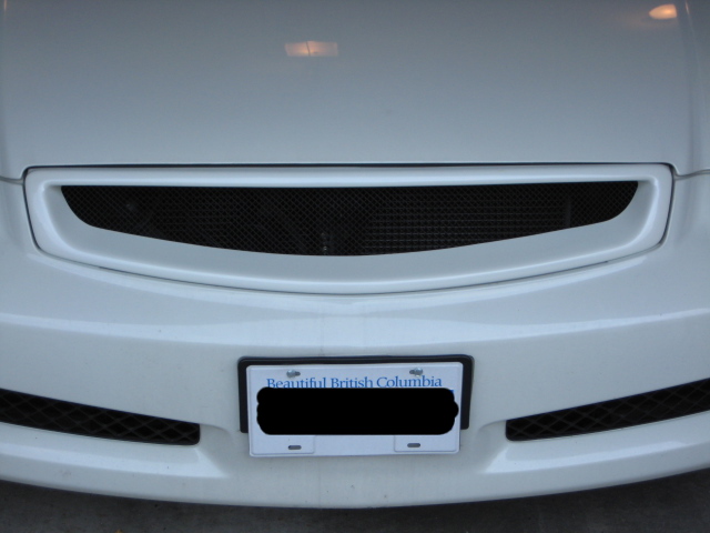

Ok, after what seemed to be a gruesome battle to the death with my oem front grill, I finally took it off and installed the Gialla replica grill from Ionic. Haaaallelujah!! Haaaallelujah!! Haaaallelujah!! Halleeeelujaaaaah!!
I don't think I did a very good job of it because the lines / spacing seem to be a bit big between the hood and the top of the grill. But whatever, I'm content, not about to take it off and add another layer of tape.
PS. Thx mx22o and Ionic for the tips/advice!!

Just installed my Gialla grille, two issues the far right hole needs to have a "rattail file" run thru it for alignment and I used double sided tape on the bottom to make it a little more secure....see not big issues at all.
Gary
