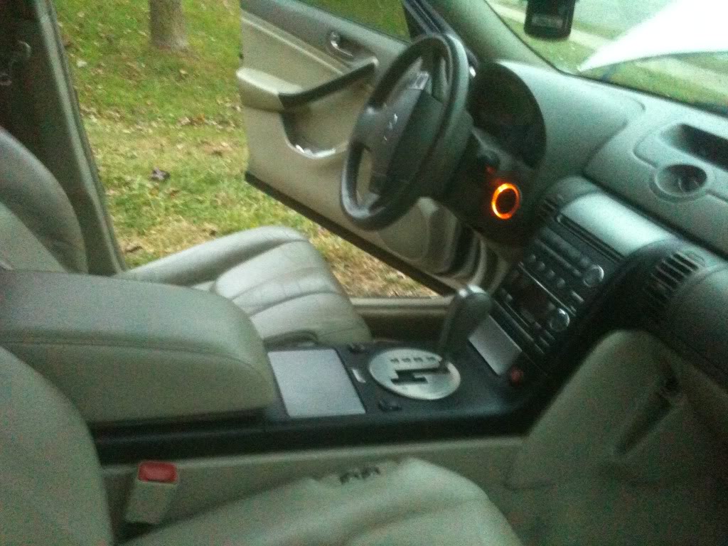

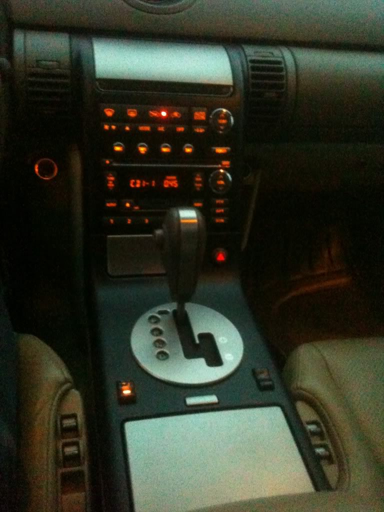

bought LED dome lights too, but this is the finished product, thanks for the tut, that was awesome...time consuming...but awesome!
