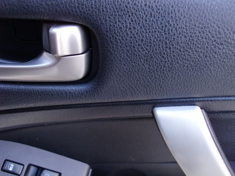

For those who want to see a visual for my attempt to copy factory finish.
Used 600 grit sandpaper to get the original paint off.
Wiped it down with 71% alcohol.
2 coats of Rustoleum Auto primer
Sanded it lightly with 800 grit.
3 layers of Krylon Brushed Metallic Interior paint in Nickle with Satin finish.
Finished with 3 layers of Krylon Clear coat with Satin finish.
This ended up being a bit more silver/lighter then my door handles but I'm happy with them. All thanks to the boyfriend's hard work XD.
We'll see how they hold up to every day use...
Thanks for the great DIY!

I wonder if a black base-coat would have darkened it enough?
Good work

Thanks! ^^ I felt like the paint really covered the primer. I would want to try a bronze topcoat or something XD.
