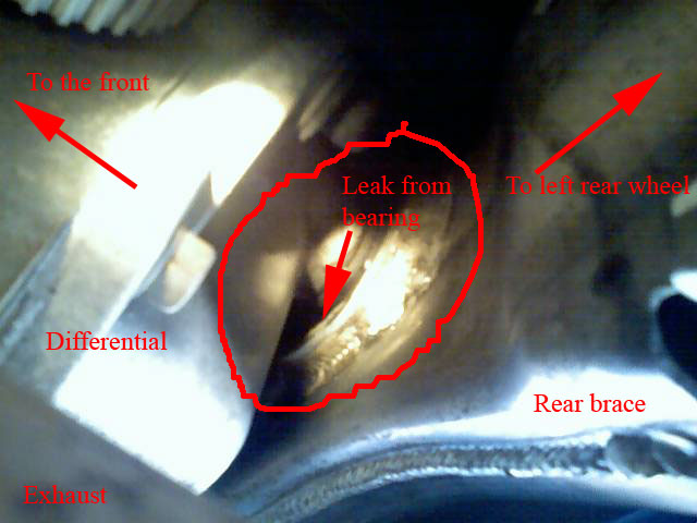

So, looks like there is a bearing to the rear from the rear differential, connecting the rear of the differential to the chassis brace. And my bearing is leaking - there is thin (not too oil-like) black-ish liquid coming out from under the bearing seal. How critical is this, and what the hell is that bearing called?... Any help is appreciated...

i think it's part number 7... not too sure though...

Yes, those rear diff bushigns are filled with silicone. It can rip and leak with enough abuse. Good news is they are replaceable. Bad news is you have to take down the rear subframe to replace the bushing. Read this on my350z not too long ago.
http://www.my350z.com/forum/showthre...erential+mount
SPL also makes a solid replacment bushing if you want to go that route but it will introduce a mess of noise into the cabin.

that's exactly it. silicone liquid leaking from the other side of this bearing (see attached)... - no, it's not my G, obviously - i stole the pic from the my350z thread above.

That's not the part you're looking for. #7 is one of the two internal pinion bearings.
