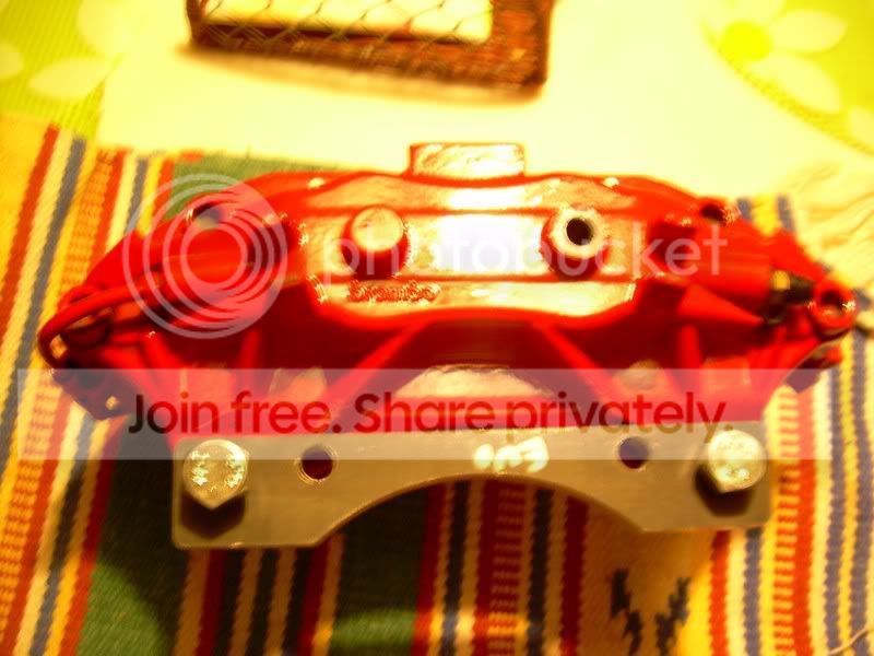

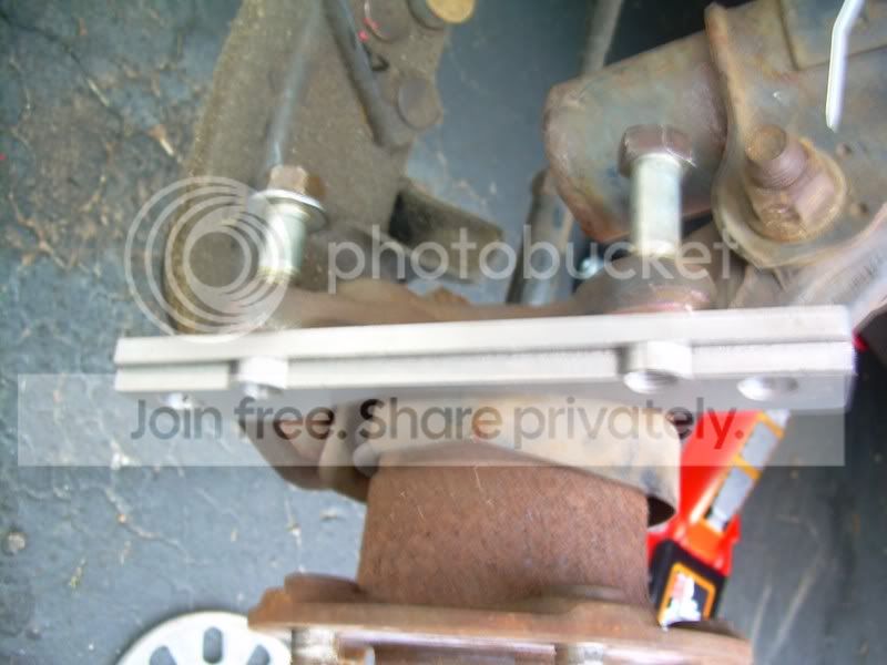

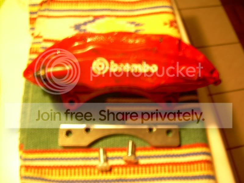

Re: Bracket pricing. You'll be very unhappy if your bracket breaks. If you are unhappy with our pricing on our brackets, then please feel free to purchase the others. As with all of the other products we sell, it is priced agressively.
Would you purchase a homemade intake for your vehicle? You could make your own for 30 dollars. However, everyone pays for tried and proven equipment, and our bracket is proven to work; we back it's quality.

Then you show supposed flimsy brackets(they are at least as heavy duty as the ears on the brembo caliper so why are they flimsy?) of adapting evo calipers after you posted above that it's not smart to do it....um..........which is it? Because it looks to me as if you are saying both while only using the pics to bash someones brackets.
