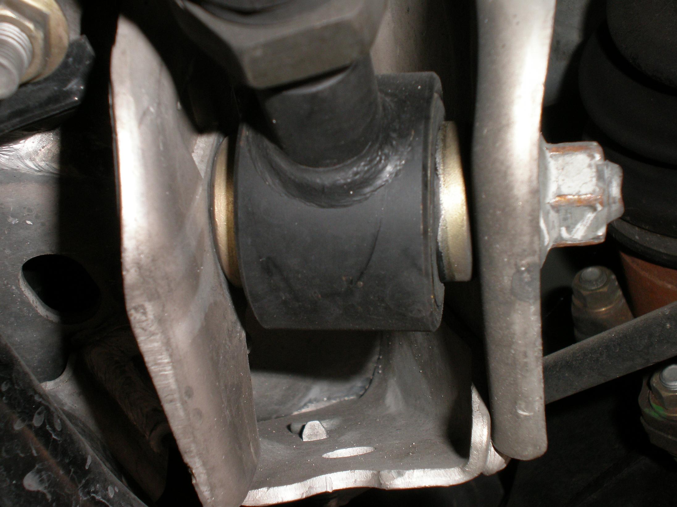

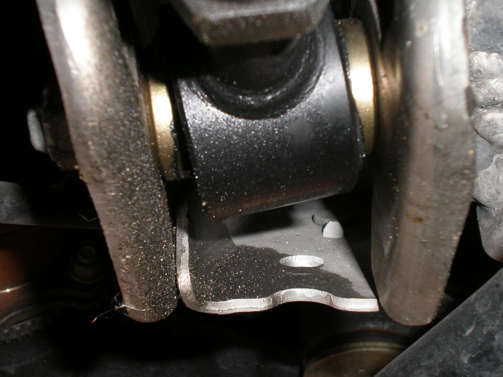

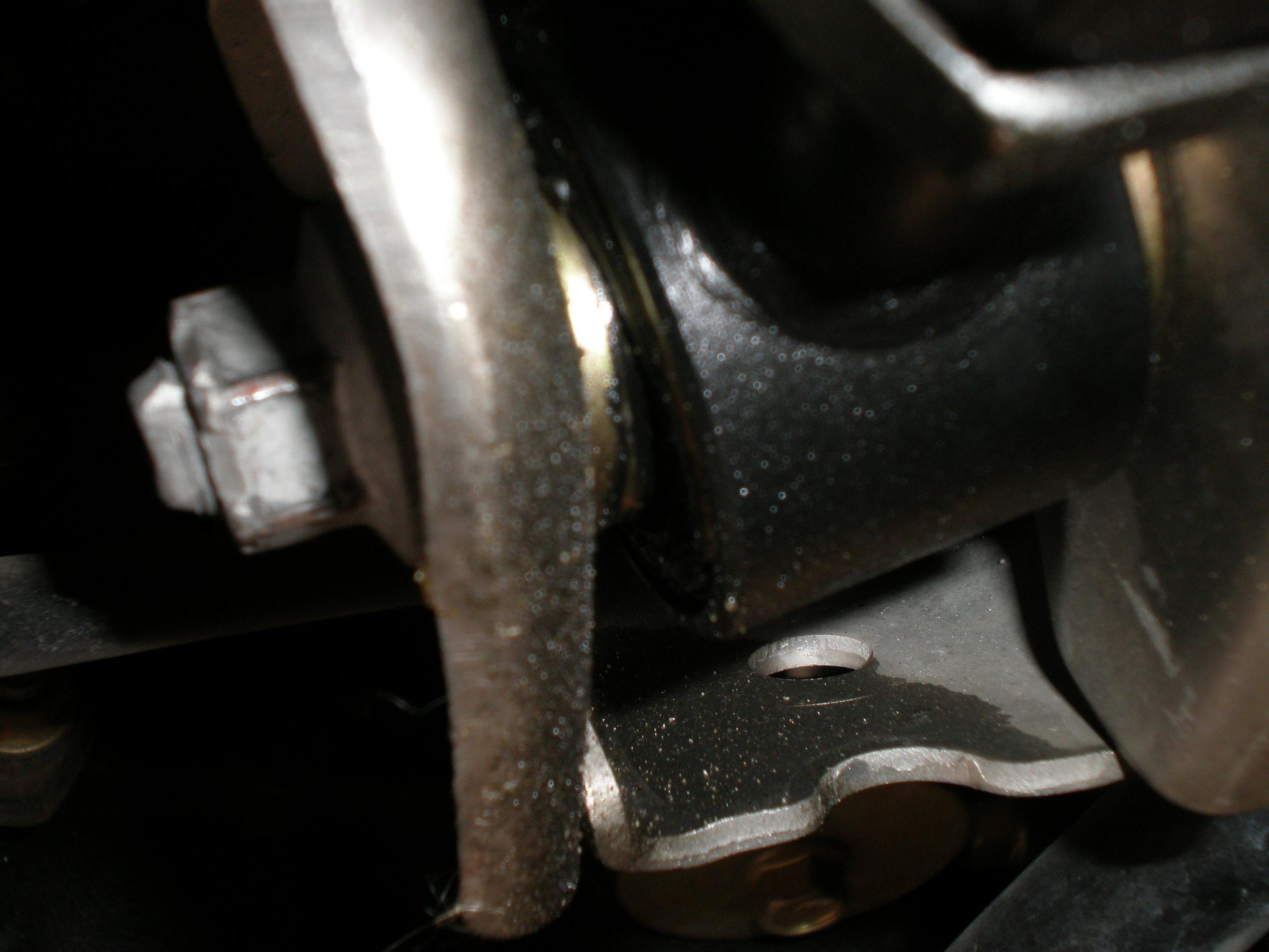

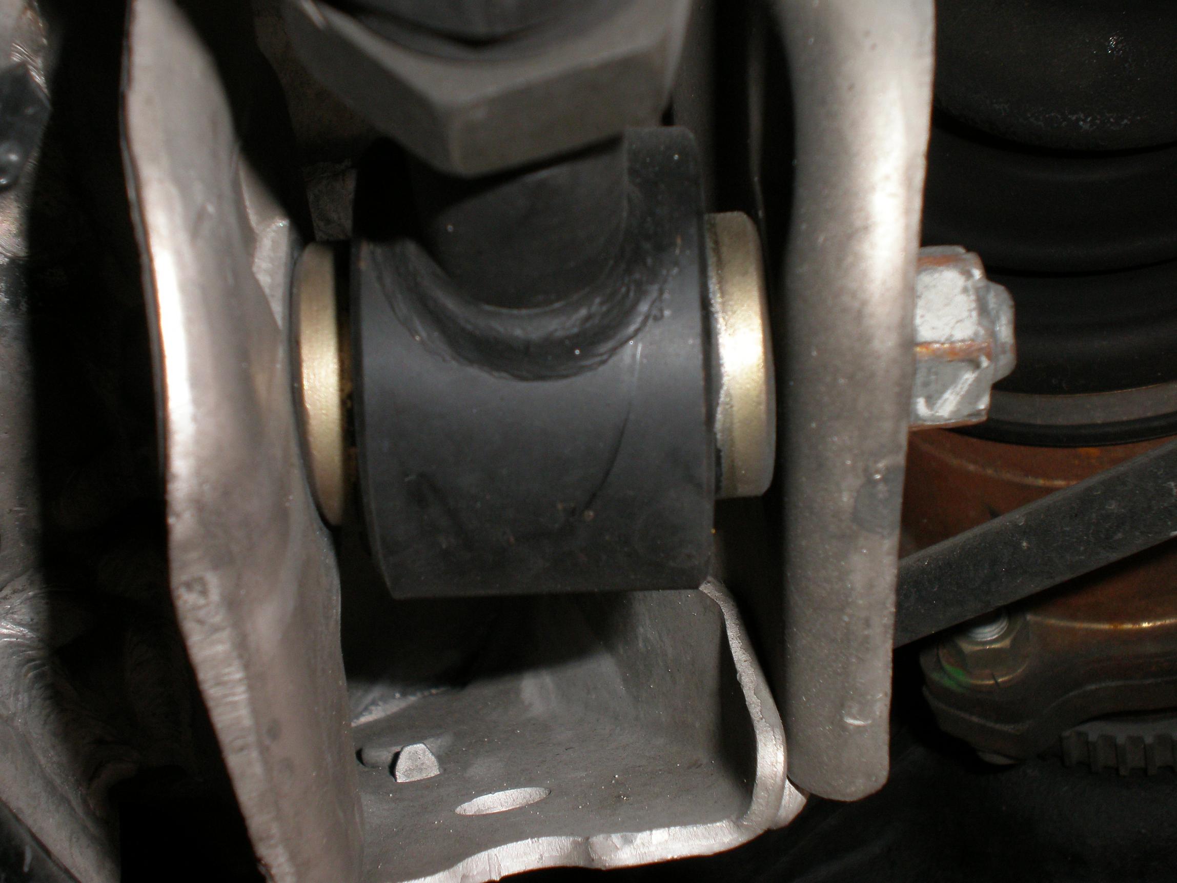

Pictures
As you can see, while on the car, the arms look to be twisted on the bushings.

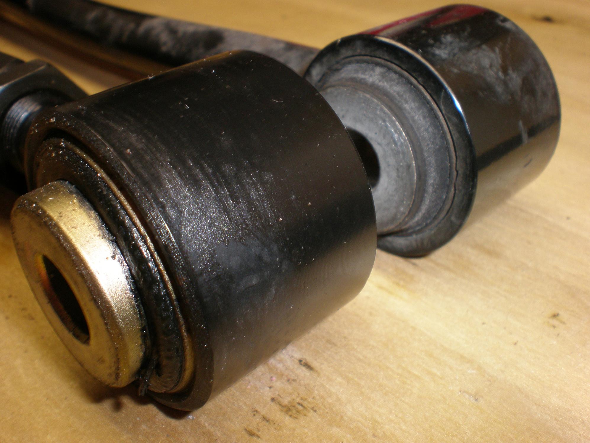

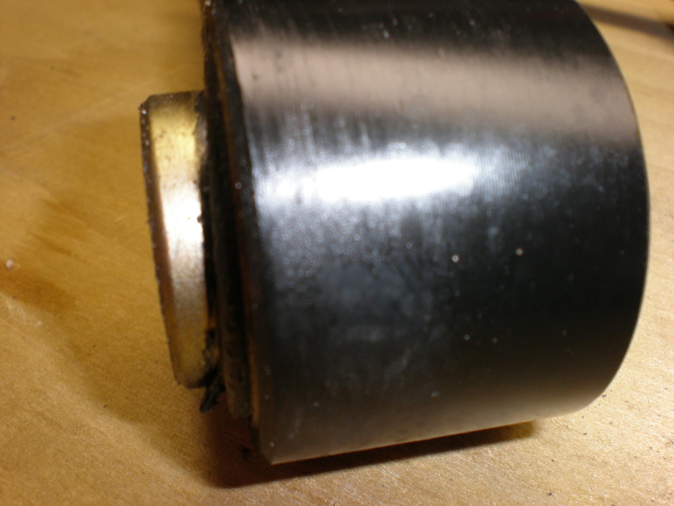

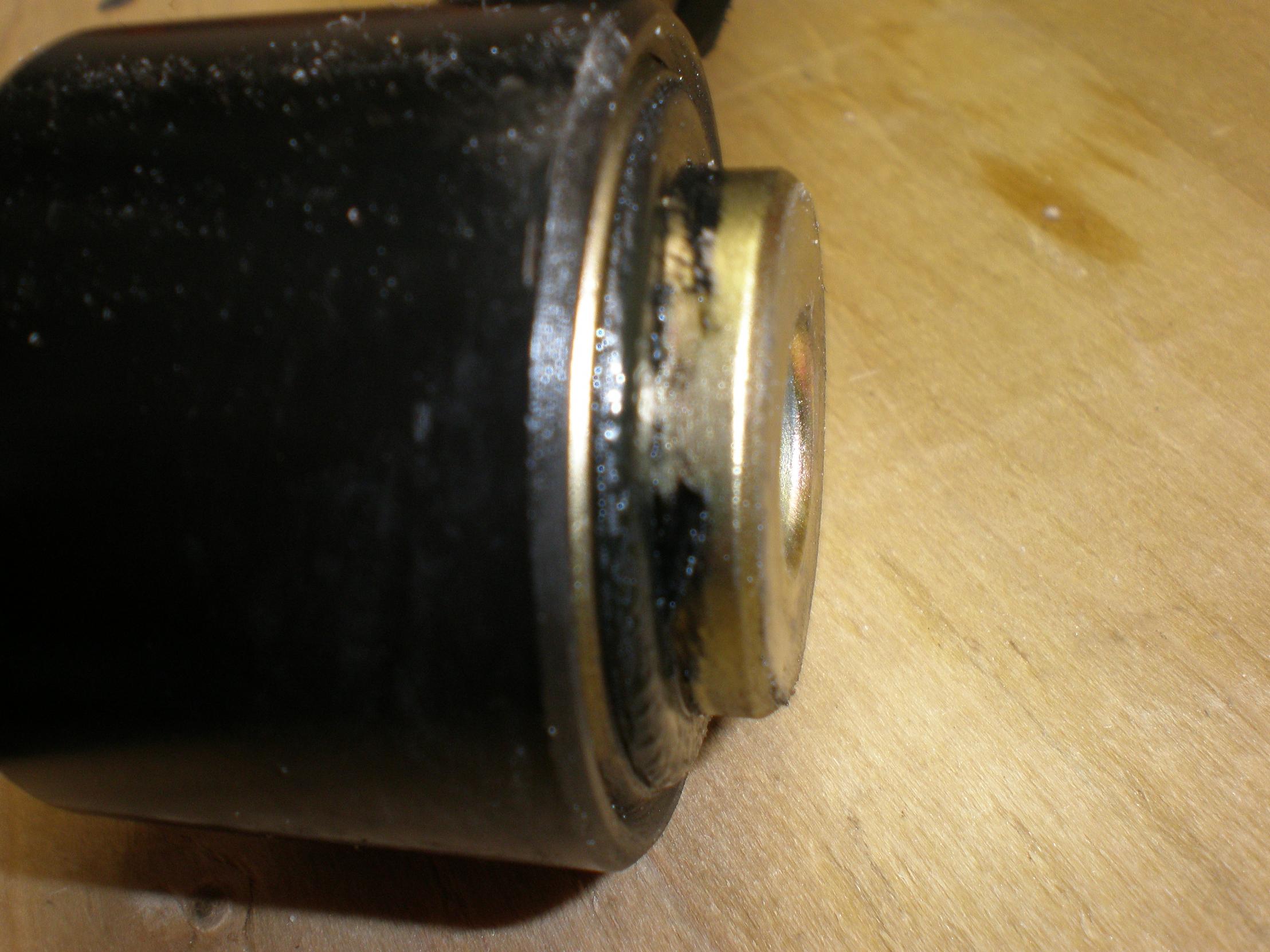

More pictures
Looking at the arms off the car the amount of misalignment (or twist) of the bushing side of the arm is barley noticeable. The bushings have clearly failed. Why? not sure. I am starting to think that the bushings have a design flaw for this application, or were defective. Hard to see in the pictures, but the metal sleeve has worked loose from the bushing material. One of the guys in our engine shop (my company builds sprint car engines) pointed out that the bushing material on the stock arms are much firmer than the SPC arm bushings. I confirmed this with my hi tech "stick a screwdriver in it test" . The plot thickens..

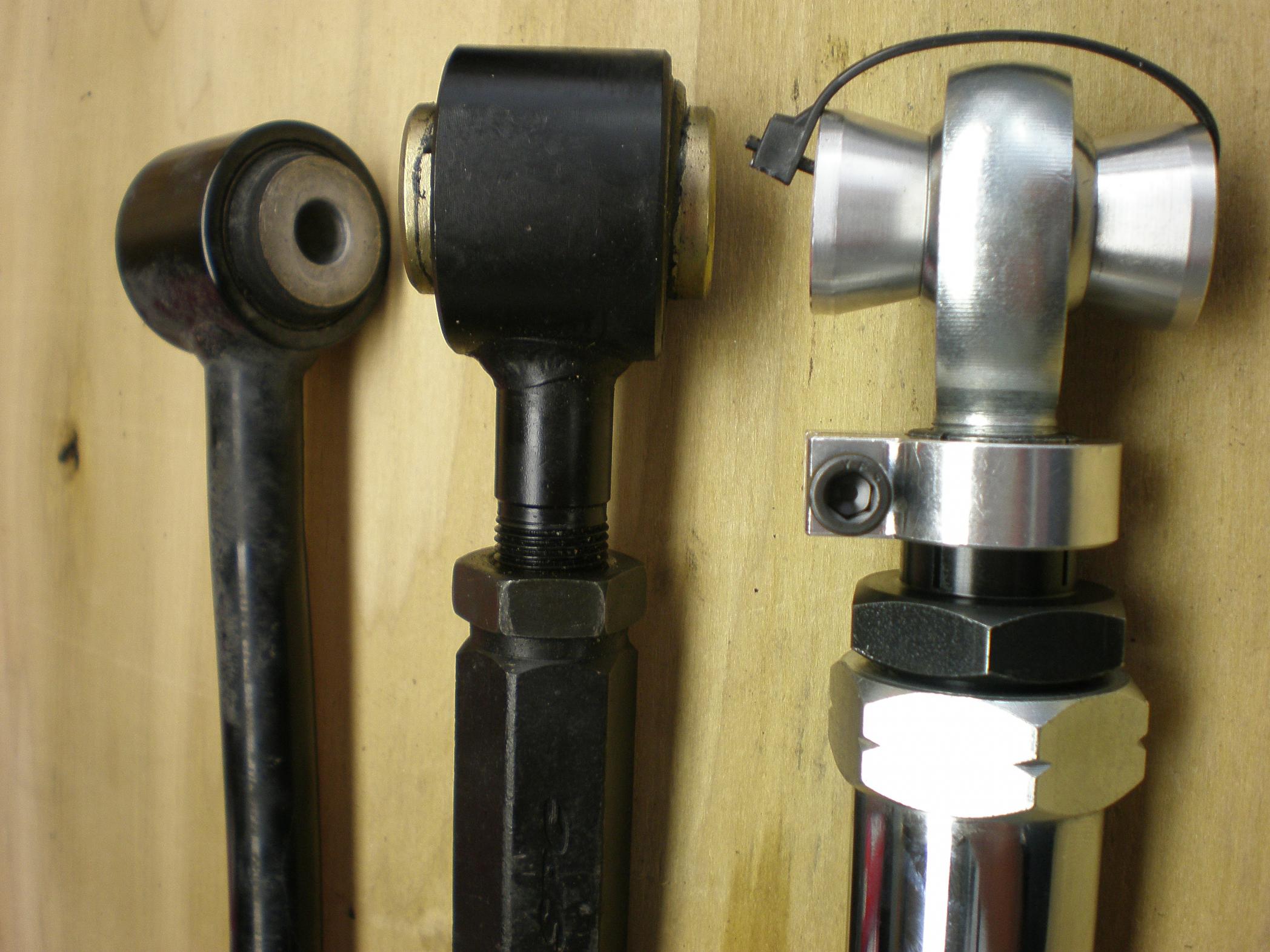

Trick SPL Lower Control (camber) Arms
Here are some pictures of the SPL lower control (camber) arms side by side with stock LCA's and SPC LCA's.
IMHO, there is no comparison between the three. the SPL arm is built like something you would see on an aircraft or race car.
Expect some additional road noise as the SPL arms do not have a bushing. For those who would want to know, I weighed the arms:
Stock- 1lb. 6oz.
SPC- 2lb. 8oz.
SPL- 2lbs.
