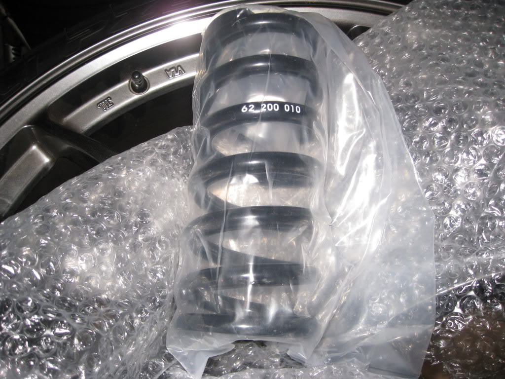

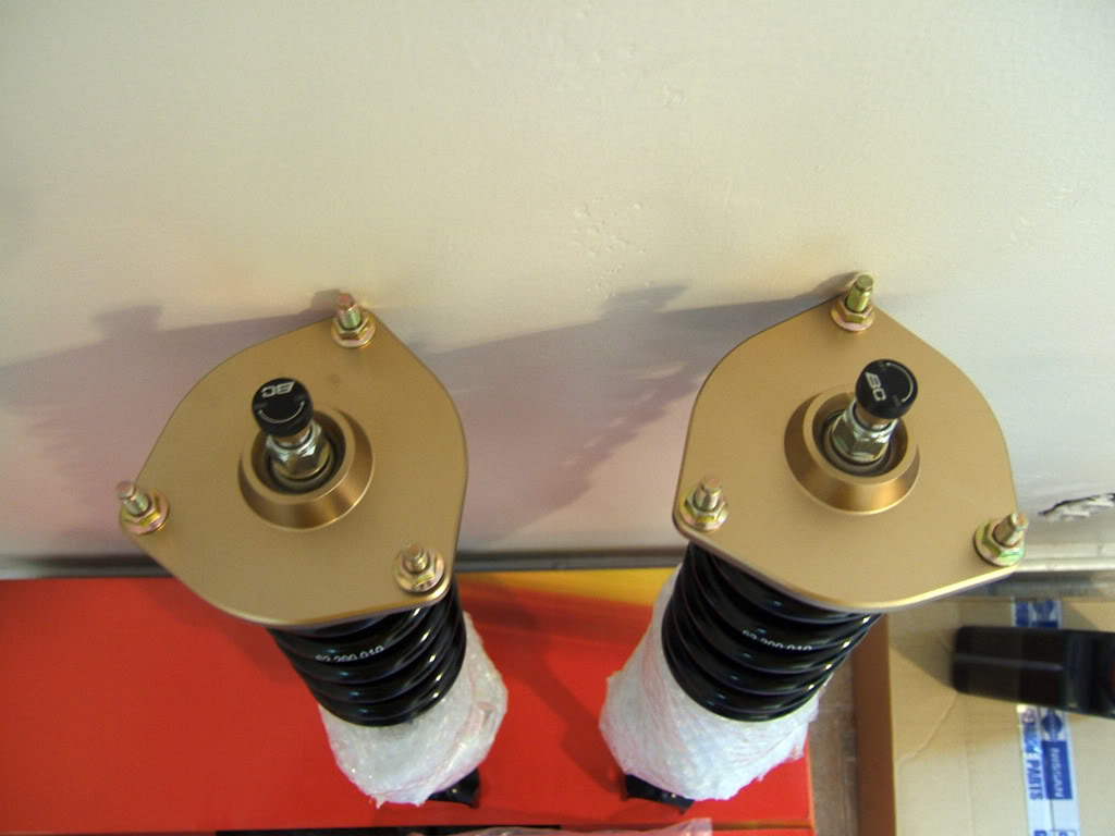

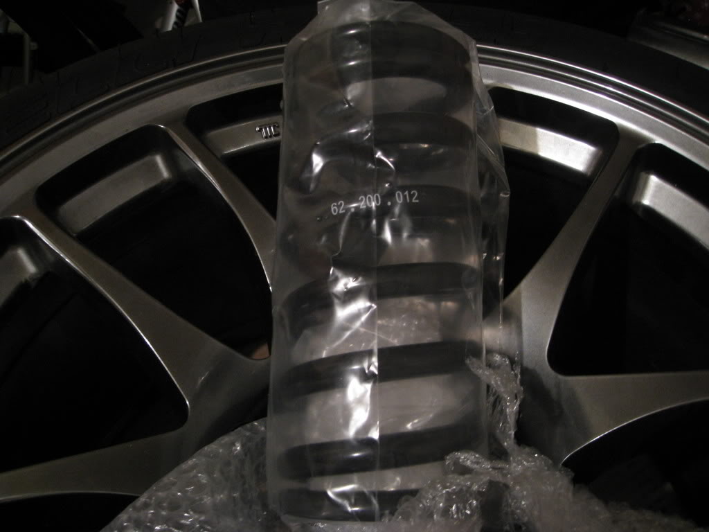

200mm is the standard
180mm is the shorter version
You can barely see the numbers here
^ These were the standard set bought from a vendor
10/8 as designated by the last numbers on the springs
^ These were a upgraded (Stiffer 10/12 as designated by the last numbers on the spring) set that I had purchased for the standard set
before opting to just buy a new set with revalved shocks and 14/12 spring rate
Number breakdown
62 = diameter
200 = length
12 = spring rate
