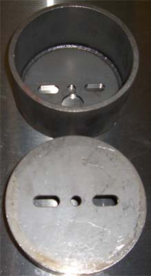

I can't remember since it's been so long since I looked but doesn't the bag fit inside of the cup? And the cup just keeps the bag from sliding around and such right? If so, how would cutting the cup give you extra space?

no the cups literly look like a cup. has a flat bottom and then has a round wall thats open on the other end. the flat part is what gets mounted on the bag surface. so the cup sits ON the bag not OVER the bag

if your bags are mounted inside of the cups then i would take them off now and make sure that you didnt not rub a ring on the bag becuase it will pop. it shouldnt even be possible to mount it like that so i doubt its like that. the bottom cup in the picture is showing the surface that needs to be touching the bag
