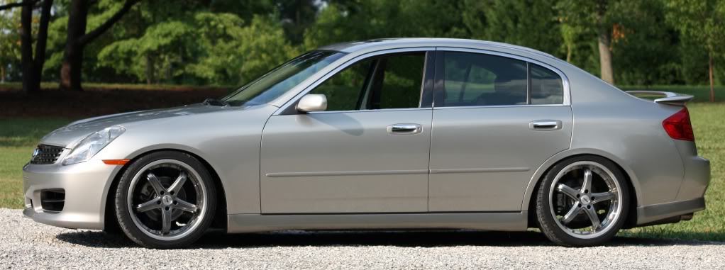

Update: It is time for a picture of the project sedan dropped on 19's and rolled fender flanges. It's been fun working out this suspension mod the past 3 months.
The fender height you see is 25 3/8" front, 25 1/2" rear, that's 2 5/8" F and 2 1/2" R of drop.

IMG fail.

"Arr, shut up. I know what I'm doin'." Harr, Harr. Harr it be fixed in 2nd try!
Muchas Gracias, mi amigo
