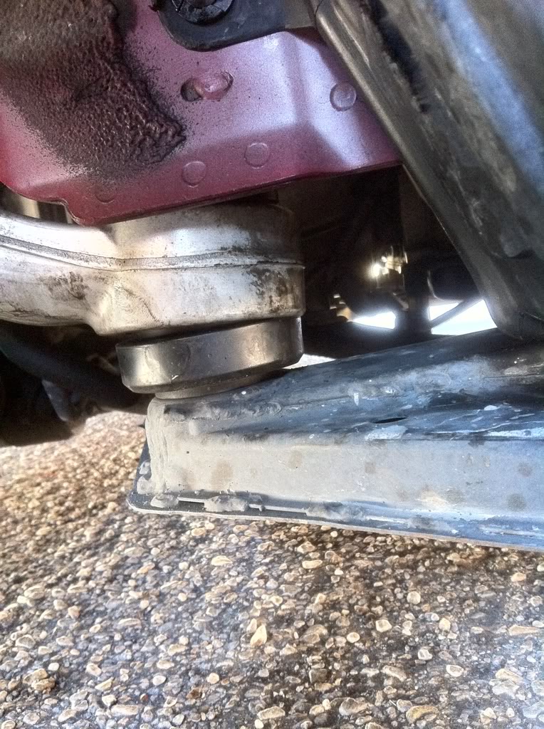

Hey vincO, I don't wanna thread jack but it seem like a waste
Starting a whole separate thread...
I did the install but are the bushings surpose
To sit this way?
Notice the gap? Is that normal? Or did I fudge up the install?

Mine looks pretty much the same. Just hit the nut one more time with your breaker bar to be sure it's got plenty of torque on it. Is the car jacked up at all in this picture? If the car's weight isn't on the wheel, then it especially looks like that. The bushing is back cut where the barrel meets the aluminum arm, so it allows it to pivot a little bit. I think that's what you're seeing.

Yea the car is on the ground thanks for the input..
I was using an air impact wrench so I hope
I tighten every thing snug. Driving wise the car feels
So much firm and the noise is gone Finally !!
