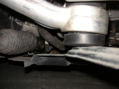

[QUOTE=datbeans;6104206]are the bushings surpose To sit this way?
Mine look the same. Also taken with wheels on the ground.

is there a DIY to instal compression rod bushings ?
I just got my ES bushings in (mine are black). My passenger side is completely blown. Im getting all kinds of road noise and having alignment issues. Guess the AWD torque to the pass side front wheel took it out.
