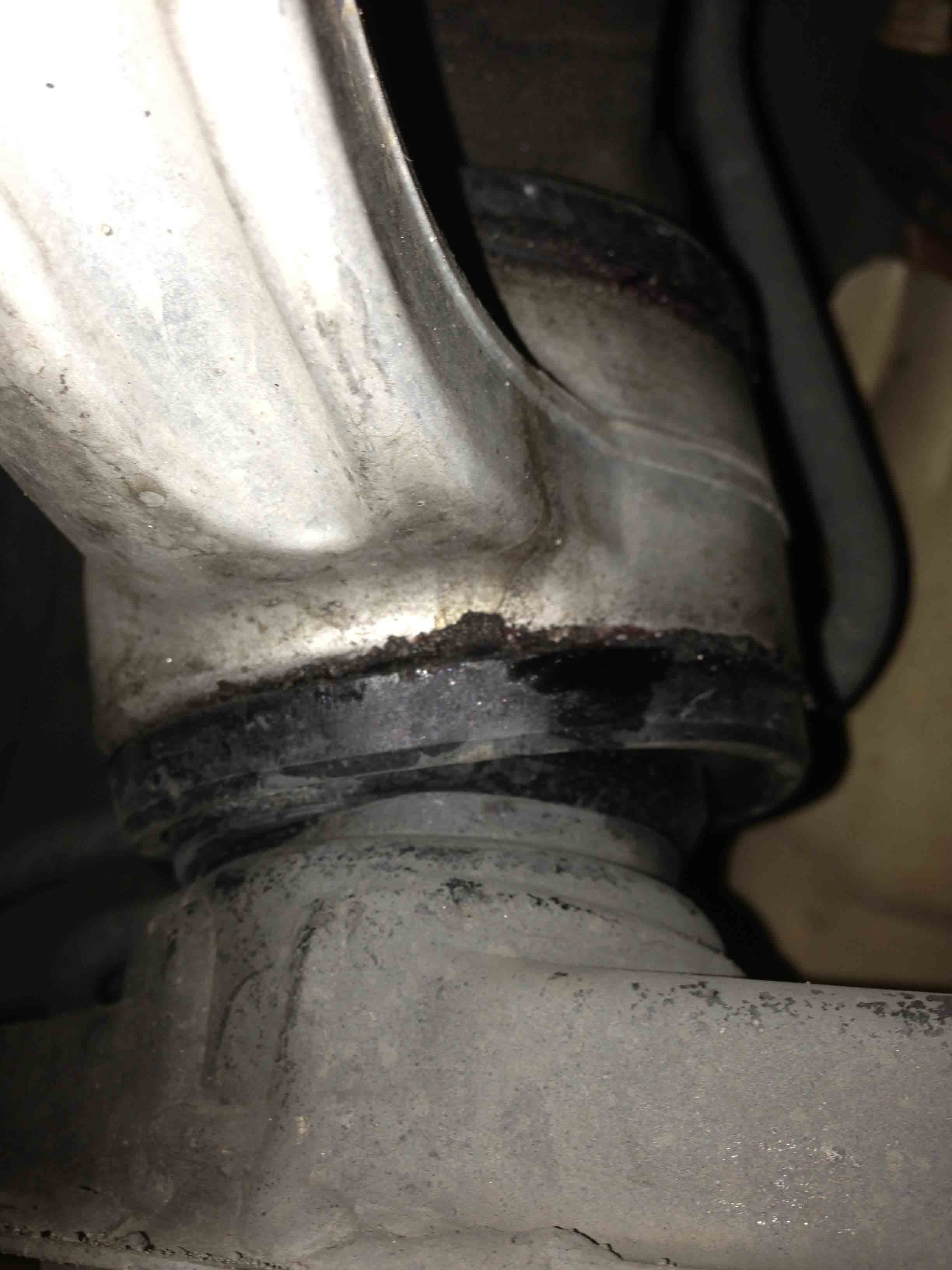

I decided to write a review on the Whiteline bushings mainly because after doing months of research, it was hard to find details and customer reviews about these bushings. (Unless my search skills suck). I decided to go with Whiteline because I heard that the SPLs make a lot of noise and has a design flaw. I heard the Energy Suspension ones also make creaking noises. I settled in with Whiteline because at the time, my understanding was that they make no noise, exceeds the quality of OEM, better for the value, and will basically last forever. Whiteline was also recommended by the shop that I went to to get this done.
So a few months ago I finally decided that the loud squeals coming from the front of my car has to go. It caused major embarrassment for a car that looks nice, but squeals like a dying cat everywhere I go. For the longest time, I have always thought that my brakes and rotors were causing the squeals, so I decided to get brand new brakes and rotors. Well, that didn't do the trick. As I dug deeper, I discovered that the main culprit to this issue are the Compression Rod and Control Arm bushings.
Do not go to the dealer. They will most likely want you to replace the entire Compression Rod and Control Arm Bushings, which will be COSTLY. I did hear that some dealers may know how to install bushings.
The only reason you should install a new Compression Rod is if your ball joints are bad. This is rare, and from my understanding, can only happen if your car is extremely low. Even then, ball joints going bad do not happen unless you abused the crap out of your car. So to say, it can still happen, but a lot more rare compared to bushings going bad. I might be wrong on this, so if someone wants to correct me that would be fine.

I have racked up 164xxx miles on my car. Over time, I have gotten used to the deteriorating quality of the suspension. (Steering problems, being able to feel every bump on the road, the squeals, etc.).
I decided to pull the trigger and get this job done. The bushings totaled out approximately $200. I found a Nissan/Infiniti shop that knows how to remove and install new bushings by using a press. Total labor to do both the Compression Rod and Lower Front Control Arm on both sides of my car came out to be $385. So in total, I spent $585 for this repair.
The day that the repair was done:
BAM!! SUSPENSION QUALITY IS BACK!!!
I absolutely cannot believe how my car feels the minute I drove my car just from replacing BUSHINGS! Not only did it get rid of the squeals that I mainly wanted to get rid of, but my steering feels SMOOTH and I NO LONGER FEEL EVERY BUMP on the road!
You do not know how much quality is lost until you actually take care of replacing the bushings if you have high mileage. I have been driving with Whiteline for the past several days already and I HIGHLY recommend them. You are likely to just install them once and forget about them. Although, if they do have problems I will update this thread in the future.
I highly recommend doing all 6 bushings on the Compression Rod and Lower Front Control Arms, even if the bushings are still good. It is for the peace of mind that you won't ever have to waste more money in the future, and for major improvement overall for your car. Those two parts are known to be the only parts where bushings fail.
