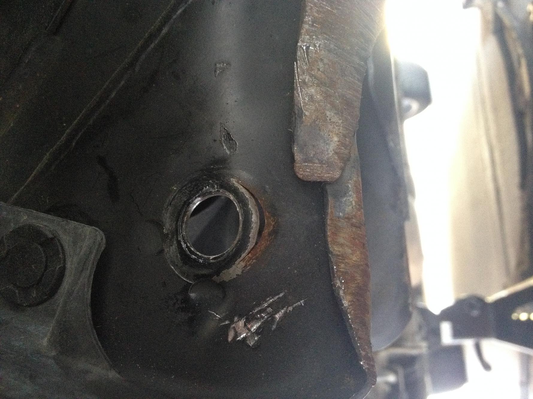

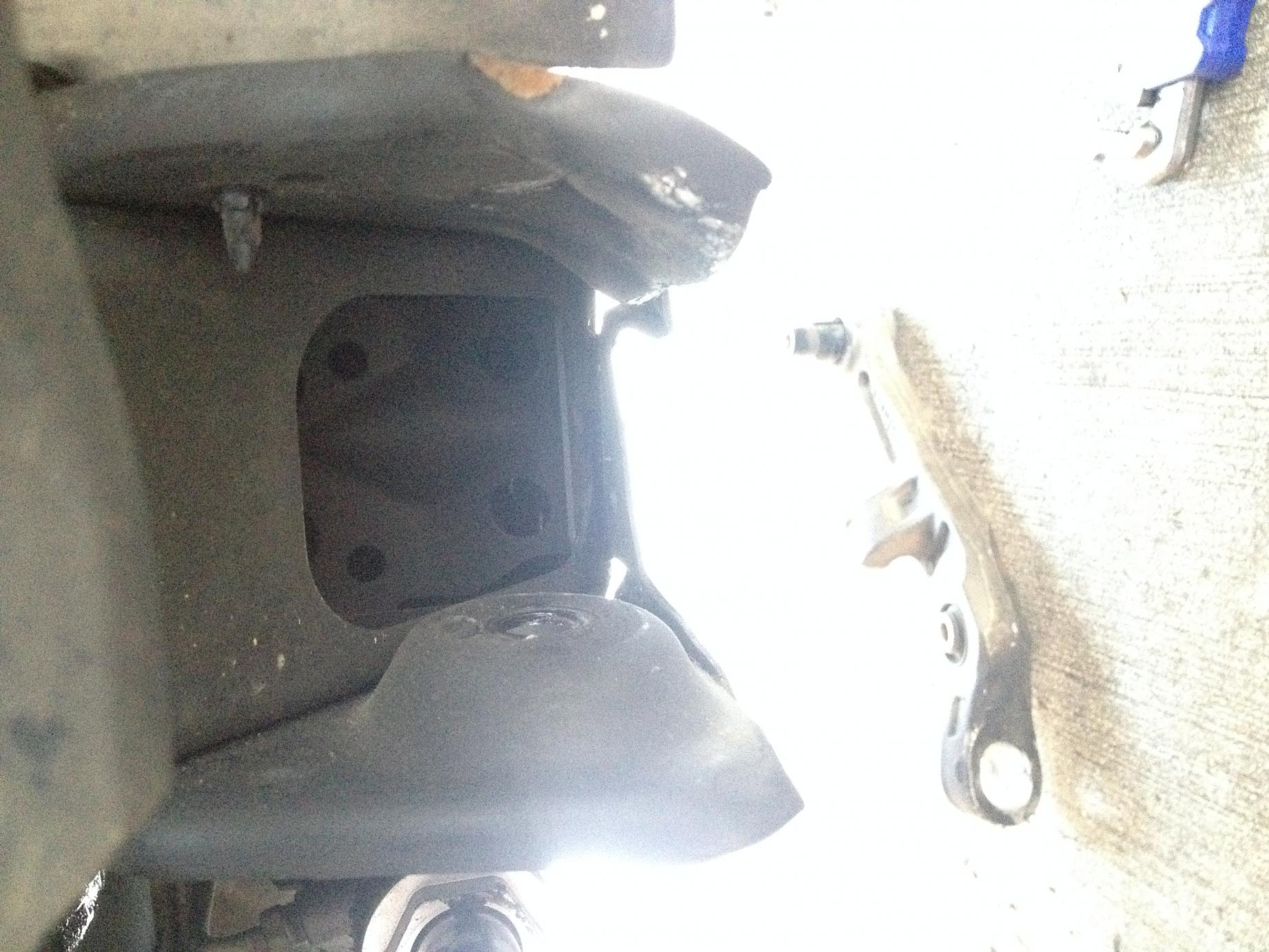

4) Finally, you saw the photo I posted earlier of the bent LCA housing. Well, in order to get the LCA out, I used a plumbers wrench and floor jack to bend it back somewhat straighter (which actually worked quite well). Once I got the bolt out and the LCA removed, I noticed this (see photos). Basically, it looks like the metal "ripped" where it bent around the bushing (if that makes sense). GEEZ! At this point, I'm thinking that I need to get insurance involved. Your thoughts on this?
Thanks to all!
PS: sorry the pics are sideways.
