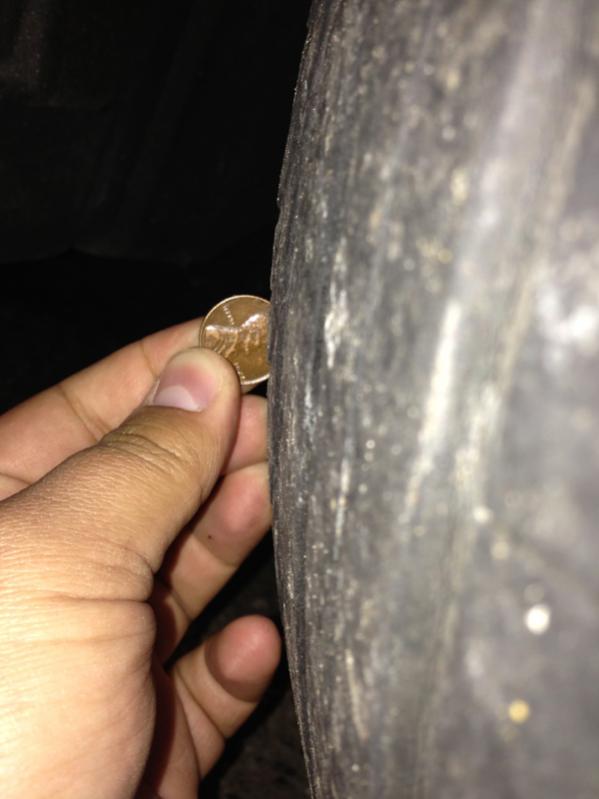

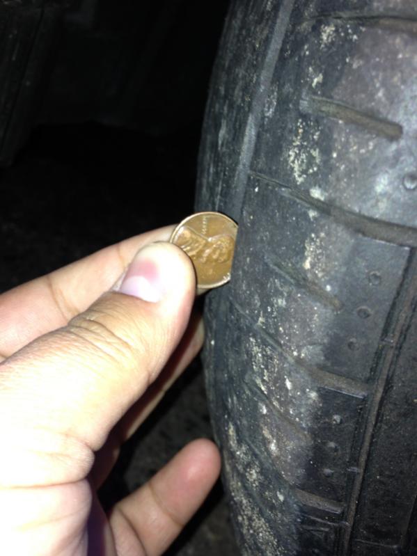

Old Nov 13, 2013 | 04:03 PM
Black04speed's Avatar
Joined: May 2012
Posts: 15
From: Boston,Ma
Originally Posted by JKL1031
hhmmm. Im only at 4k with -1.5 and 2. u mind sharing pix?
Far back of tire
Old Nov 13, 2013 | 05:19 PM
JKL1031's Avatar
Joined: Dec 2012
Posts: 1,990
Likes: 111
10k total miles? Maybe u do need plates.
