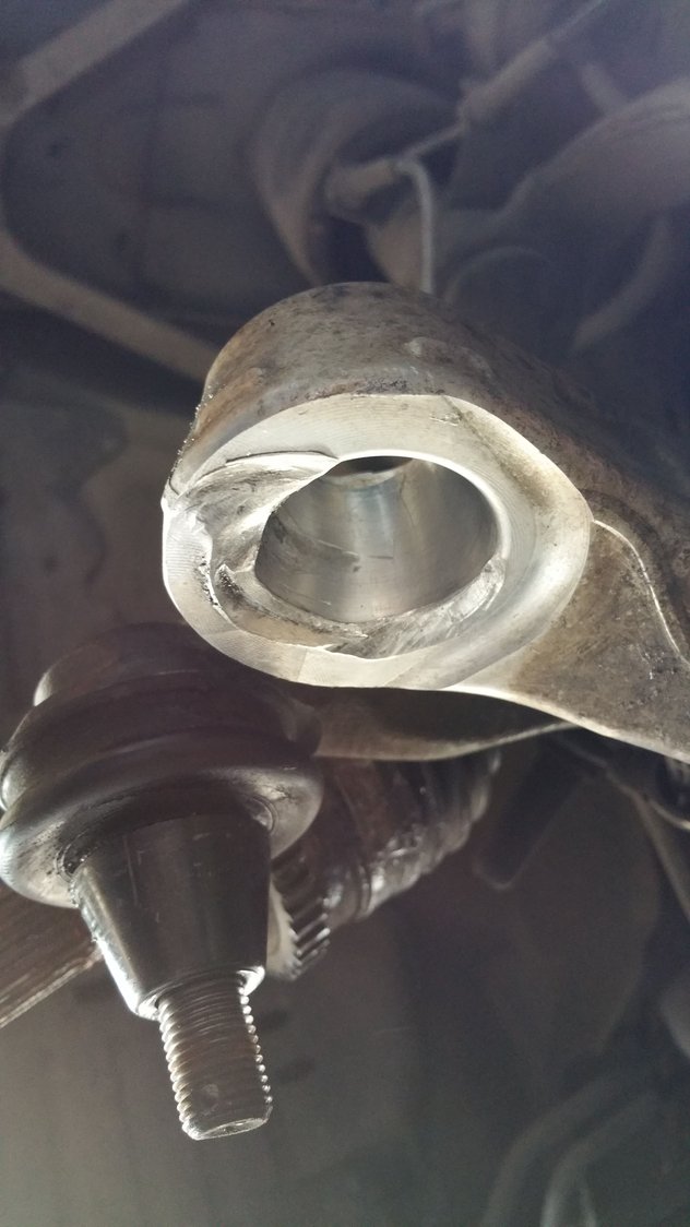

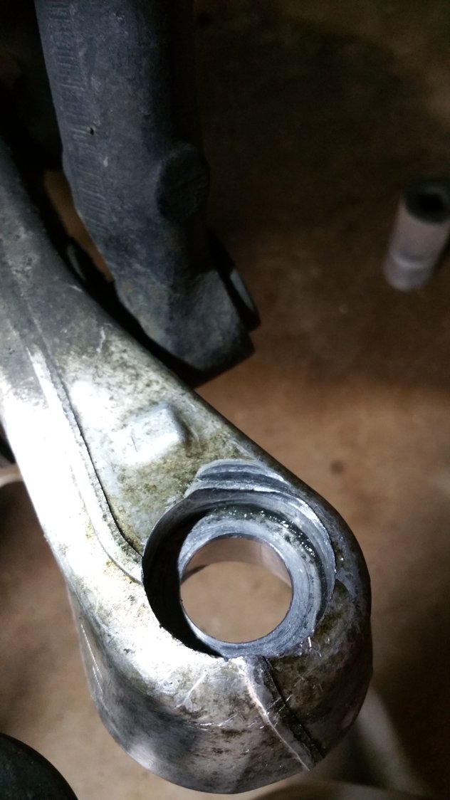

So I took the car apart after getting 5 new tires and found the front lower control arm (aka tranverse link) is completely worn where the lower ball joint sits. This is the passenger side but I'm sure driver's side is the same or worse. I didn't get the ball joint tightened down enough and it's going to cost me. Any advice on replacements? Aftermarket vs. junkyard? The boot connecting to the transaxle is also shot.
View of the lower control arm from the top.
Same control arm on the bottom.

I am unable to find a AWD version of the front lower control arm, I'm guessing there isn't one. Can someone confirm this?

Fellow X driver here...
You should be fine with your lower control arm, remove the burrs and deformed material and the taper should still lock in fine.
CV axel boots are cheap online and come as a kit, buy the kid for the side you destroyed, no big deal.
Ball joints are available everywhere, aftermarket if you're lowered too. I bough the cheapest ones I could find a few months ago and their quality was fine for me and I drive pretty hard.
So you should only be in the hole for about $60, add in a torque wrench to do the job properly next time... $150 total.
Make sure you go back and look over every nut you touched and recall yourself tightening it before you put the wheels on the car no matter how late or cold it is!
Good luck!
