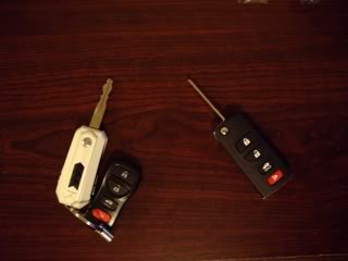

I got the same key but mine is so much more awesomer

Originally Posted by netcbc
details
Went from setup on the left to the setup on the right.
