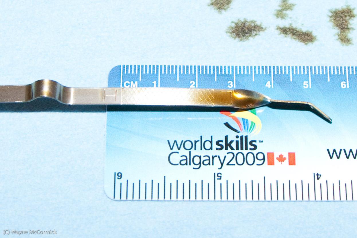

Well, I have to admit, Hyatt made me happy today.
I just finished the 3,000 km test. The photo attached shows my measurement at 2,444 km into the test. Based on the TSB, they ordered me a new short block which should be here next week. The repair/replacement is supposed to take two days.
The test itself was painless. I didn't even have to kick and scream to get them to do it either.
What are peoples experiences with this kind of repair? What should I look out for? I've never had anything this major done on any of my cars before.

That is very good news William. From what we can see it looks like about 2 cms. What is that in litres? I thought it needed to be more than 1 litre per 1000km.
I don't have any experience with with the repair but hopefully others will chime in. Likely you're not the first one they've done though. Neither of my Infinitis used any oil and my Nissan doesn't either.

looks like 1500 miles you were down 20mm

I don't know what that is. I thought it was one litre between the L and H marks, but I don't know for sure. The service bulletin does talk about litres/distance, just millimetres per mileage group. BTW, I'm Wayne #2 Calgary branch.
Yup, that's what I read it as. Even giving them 18mm, I'm in the No Good area on the graph.

^I'm thinking of changing my name so I can be W4.
And I always thought the gap between L and H was a litre too.
if that is correct then half way is only one quart..

Sorry about the name Wayne.
It would be interesting to see what the volume is. You're right many manufacturers used 1 litre as the amount between full and add. It seems Infiniti seems to be a lot more - at least double that.
