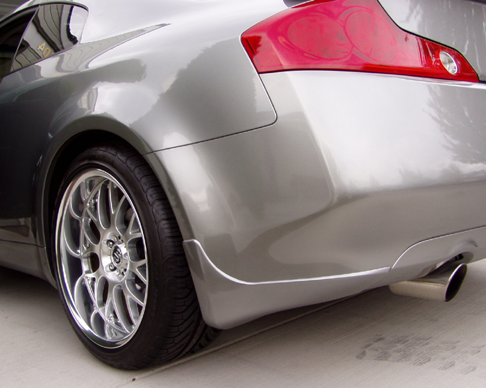

I got my G two weeks ago and last weekend I spent 2 hours washing, using a paint cleaner, and mothers wax to get her lookin nice. However, I looked at her in the sunlight, and it looks like the wax is smearing?! If I take a cloth and wipe the car, the smear goes with the direction of the wipe, so I know its not just sratches. It looks kinda like there is an oily film or something on there that I can get rid of. I washed her again today and they are still there. Any thoughts? Think the dealer could have applied some funky "wax" type thing to the paint before I bought it and is messing with the wax finish? I'm affraid I might have to remove all the wax and start over . If I do, what might be the best way... use some Dawn dish soap and then rewax? Think I should use a cleaner wax/swirl remover type product between was and wax?

Dawn, Clay bar, and ZAINO it!

I don't think it's the wax that's smearing, it's the paint cleaner. Waxes dry over time, they don't remain oily. Paint cleaners and polishes however have many oils and if you don't wipe them off completely before applying a wax or sealant you're stuck with the holograms until you remove it all. The best way to remove this oily residue after using the cleaner is to fill a spray bottle with rubbing alcohol mixed 50:50 with water - spray each panel and buff it off, make sure to be very thorough (get all spots). This will leave the paint absolutely naked and ready for wax.
Regarding future wax removal - Punchit is right, using dawn on a regular basis is a bad idea if only because it can dry out trim. You're better off stripping wax/sealants with the alcohol/water mix, then washing with a good automotive soap.
