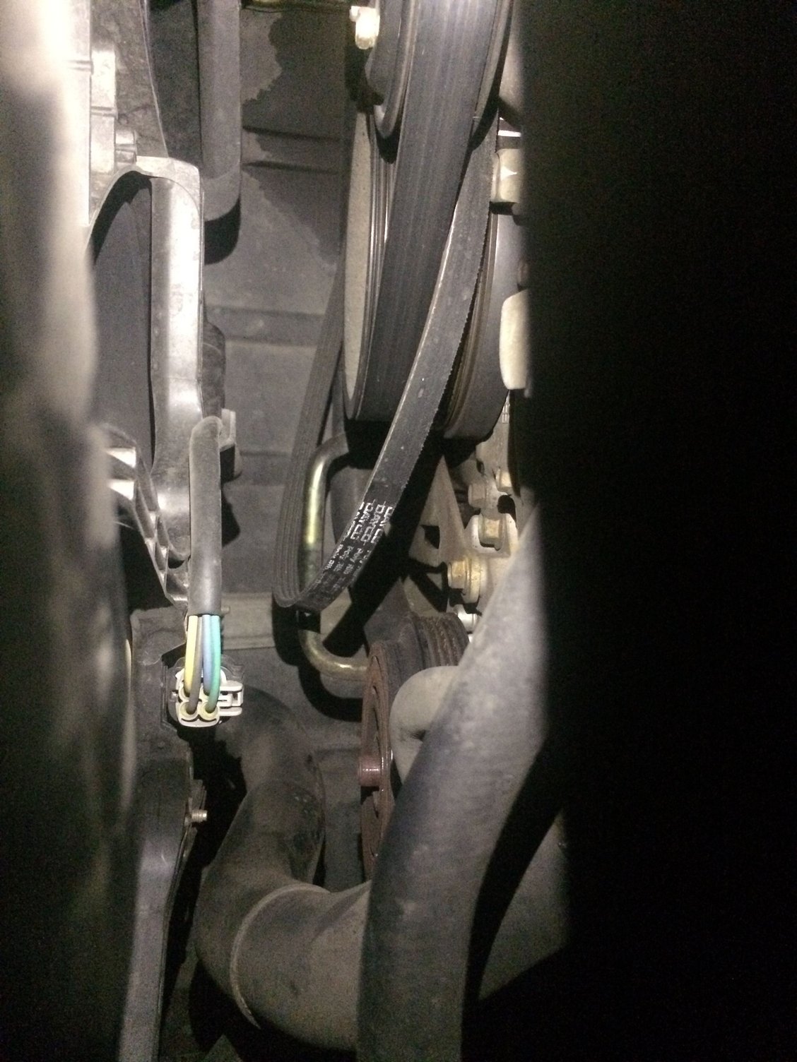

I didn't have the knowledge and went to Sears not long ago and had my serpentine and ac belt replaced. Both were cracked and dry rotting. Well yesterday I noticed no cold air from my ac unit. So I checked the fluids and started checking the hoses. Come to find out my belt is off! Looks unused! I cannot figure out how or why this happened. Neve had this issue before.
The belt came off

I'm almost certain they didn't tighten up the tensioner bolt after they turned the tensioner adjusting bolt. Sounds like it's Sear's fault. It's very easy to do the belt yourself after you remove the top air intake scoop (a few clips) and the bottom underside cover (around 14 10mm bolts to my recollection). Up to you if you want to take the car back to Sears and see how they handle this epic fail or just fix it yourself.

I took the car back had them fix it. Well after 20 min of driving a sound came from nowhere. Then I took it back again. Turns out what happened is they try to use a non OEM washer or something can't remember. But that cause the new pulley they put on for free and bolt they replaced for no charge as well; to come off. They explained it was their fault. So they are ordering the correct OEM part to Do it right. I'd do it but until I move I cannot get underneath the car. She sits low and I live on an incline. If you ask me that's pure honesty. However it would just have been better for them to do it the first time. They stayed calm the whole time. Most places say **** off when ou return.

Yeah, sure does sound like pure honesty. But I still question why they tried to do a hack job in the first place. I'm guessing they must have snapped some bolt (could be from over-torquing...who knows) and tried to workaround the problem with a washer. Based on the failure you described, it would most likely be the bolt that you tighten up on the center of the tensioner pulley. Anyway as long as they fix it for free (after admitting fault), then you're good to go!

Well they went to infinity And bought the whole assembly, bolts pulley and belt. Installed and no charge to me. Now everything is good just need to recharge my ac haha!
