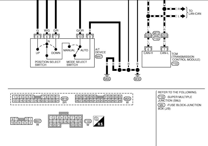

So I read this post @ work about “pull back, shift up”. Driving home my brain wants to pull back, only to hit redline. This needs to be fixed. So here it is. Took me less than a hour and that’s only cause I triple check along the way. First I accept NO responsibility. Everything here is for 04 coupe. Quick check of 03 sedan and 06 coupe shows all the same. Have fun.
With engine off, put gear selector in drive.
Remove shift ****. Remove consol trim.
DISCONECT negative battery cable.
At front of shift selector you’ll find connector “M47”
With small flat blade pop “M47” out of hold clip.
Separate connector. On the male pin side, remove both the pin retainer clips.
With needle nose pliers gently pull on wire to release pin.
Swap 7 and 8. Re-assemble.
After a spirited test drive, I can’t call this a mod, it’s a fix. I have a more positive up-shift and less chance of premature downshift. It took virtually no getting use to, it cost NOTHING and if you don’t like it you can return to stock and no one will know.

Just did mine and wanted to share some pictures.
Here you can see actual M47 location
Here you can see what it looks like unplugged
and finally the two wires that need to be switched.
(Green/Red left - Green right)
