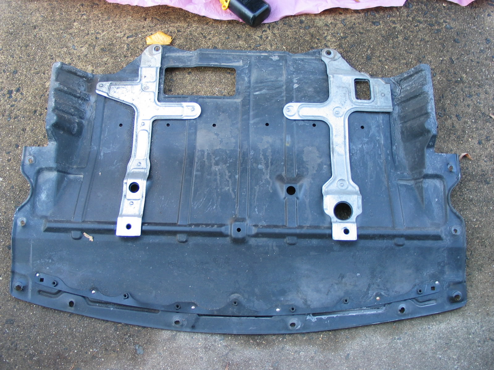

Front and rear cameras, tire pressure for all four tires can display on screen,folding side view mir
I think your first step is to replace the fiberboard splash shield underneath your vehicle.
Or you could just order a case of parts that you can replace every time it rains

Originally Posted by Kyronsk8
so I will be taking your advice with the splash guard. Following up for future readers, I swapped to a different ecu and it’s still in limp mode so I’m guessing it’s not the ecu. Cleaning my k&n filter and maf. So will testing those tomorrow once the filter is done.
Wondering if my car will shut off after my maf is unplugged while it’s on. That would say that the maf is bad right?
It is not a big deal to remove that shroud for oil changes. Takes 2-3 min with a cordless drill with a 10mm socket adapter to remove the fourteen 10mm bolts
Telcoman
