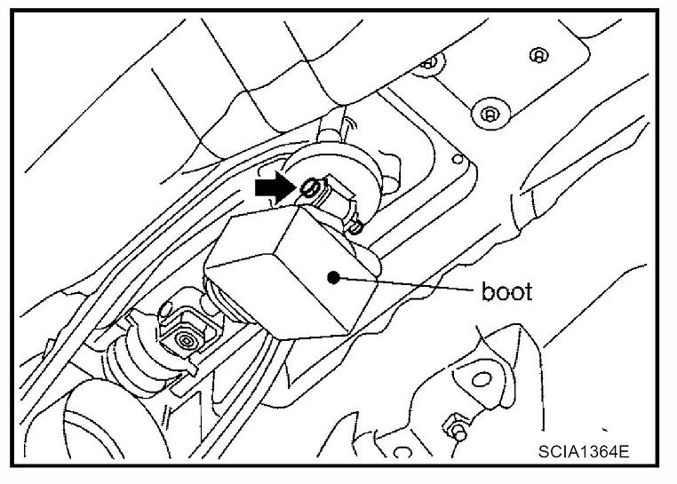

hmm..odd I haven't taken the G's transmission apart before but many experiences with hondas. From the looks of the illustration, the linkage in the G is quite short compared to hondas. I'm thinking that bolt to the linkage snapped, if not that..then the other one thats closer to the case.
Are you the original owner? Maybe it was taken apart for a clutch service, short shifter installed, etc....and wasn't properly assembled back together.

It was dark so i couldn't really see what was hanging, but it looks like the illustration you have.

def sounds like a problem with the linkage, hence you can "float to all the gears" and you're still stuck in 1st. the Stick isnt connected to the tranny anymore.

So, I just got the car back from the dealership. They didn't charge me anything. They told me it was just a simple bolt that came loose. They fixed it in a day.
The gear feels like a new car now. I am surprised at how good the gear feels actually. So accurate, so precise. I recommend every one making sure all the nuts and bolts are tight.

same thing happened to me the day i bought my car. im from jersey and i got the car from maryland and by the time i was in jersey i couldnt get it in 5th 6th or reverse. i put the car up in the air and pulled that boot off and the bolt holding the shifter to the rest of the linkage was halfway out. so i put it back in and added another nut kind of as a jam nut and havent had a problem since. glad to hear they didnt charge you anything either
