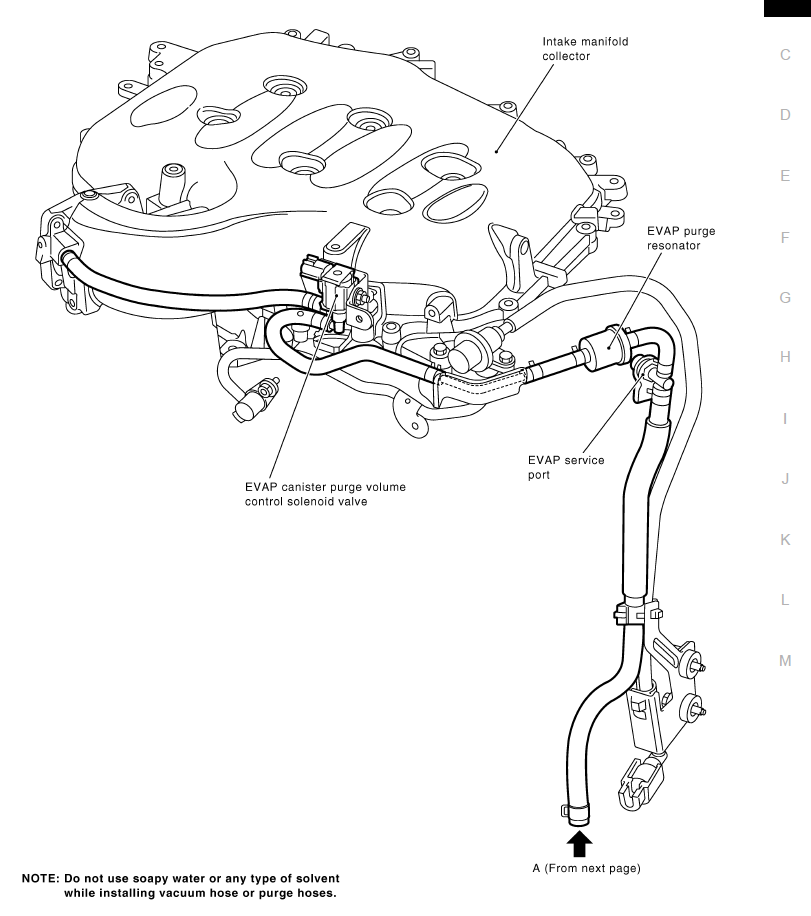

Where does the other end of this EVAP hose connect to?
Doing a valve cover job and struggling with that stupid wiring harness brace on the passenger side and I notice that the evap hose is not connected, I did not disconnect it(I mark everything I remove) does anyone know where it is supposed to connect

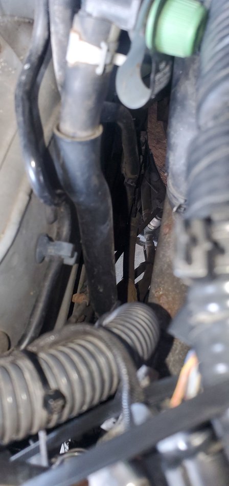

Having a really hard time seeing what's disconnected, circle it in red if you still need help.
Evap service line

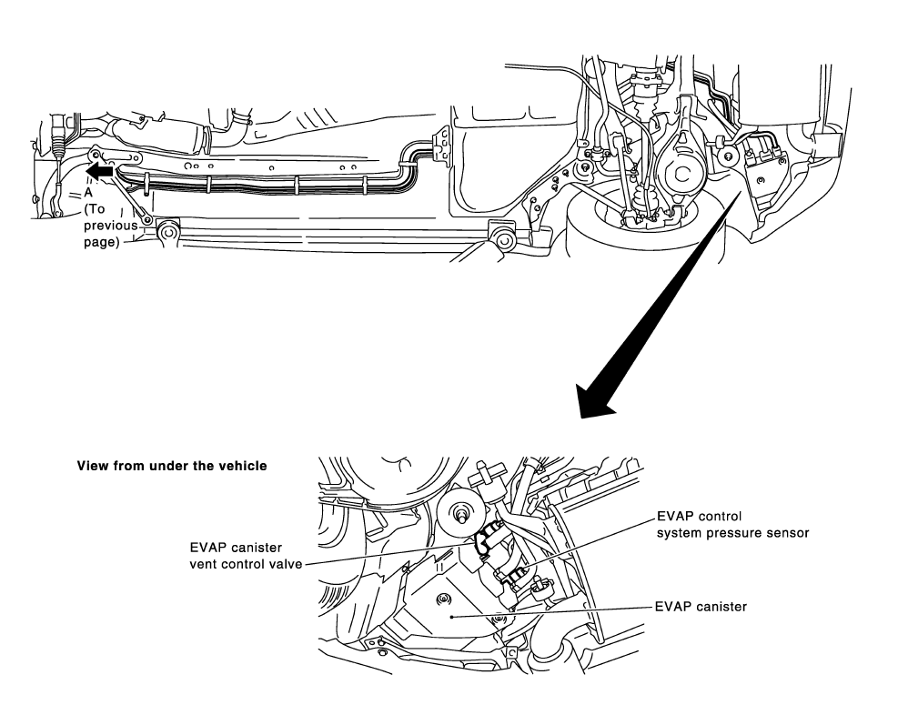

These pictures from the FSM do a better job of explaining than I can do with words.

If you have a sedan then the EVAP canister is in a different location but you should get the idea by looking at the coupe one.

Doesn't that run down under the car?
