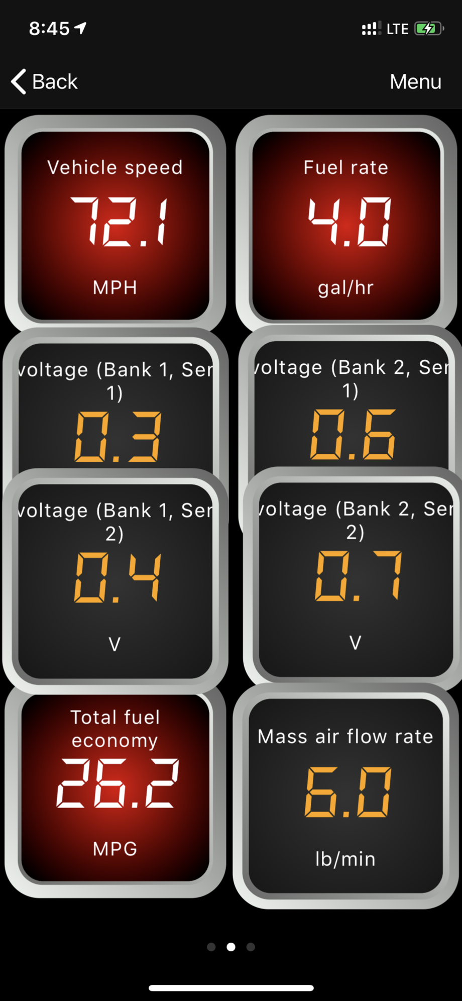

Will do. In the meantime I did capture some live sensor data while taking a drive the other day. I thought o2 sensors should always operate between .2 and .8, but when I am on a decel at 65-75mph, one of them pegs at 1.3v until I get back on the accelerator.
Coasting
On the gas
Last edited by RuZZeLL; May 23, 2020 at 11:52 AM. Reason: Pics or it didn’t happen
