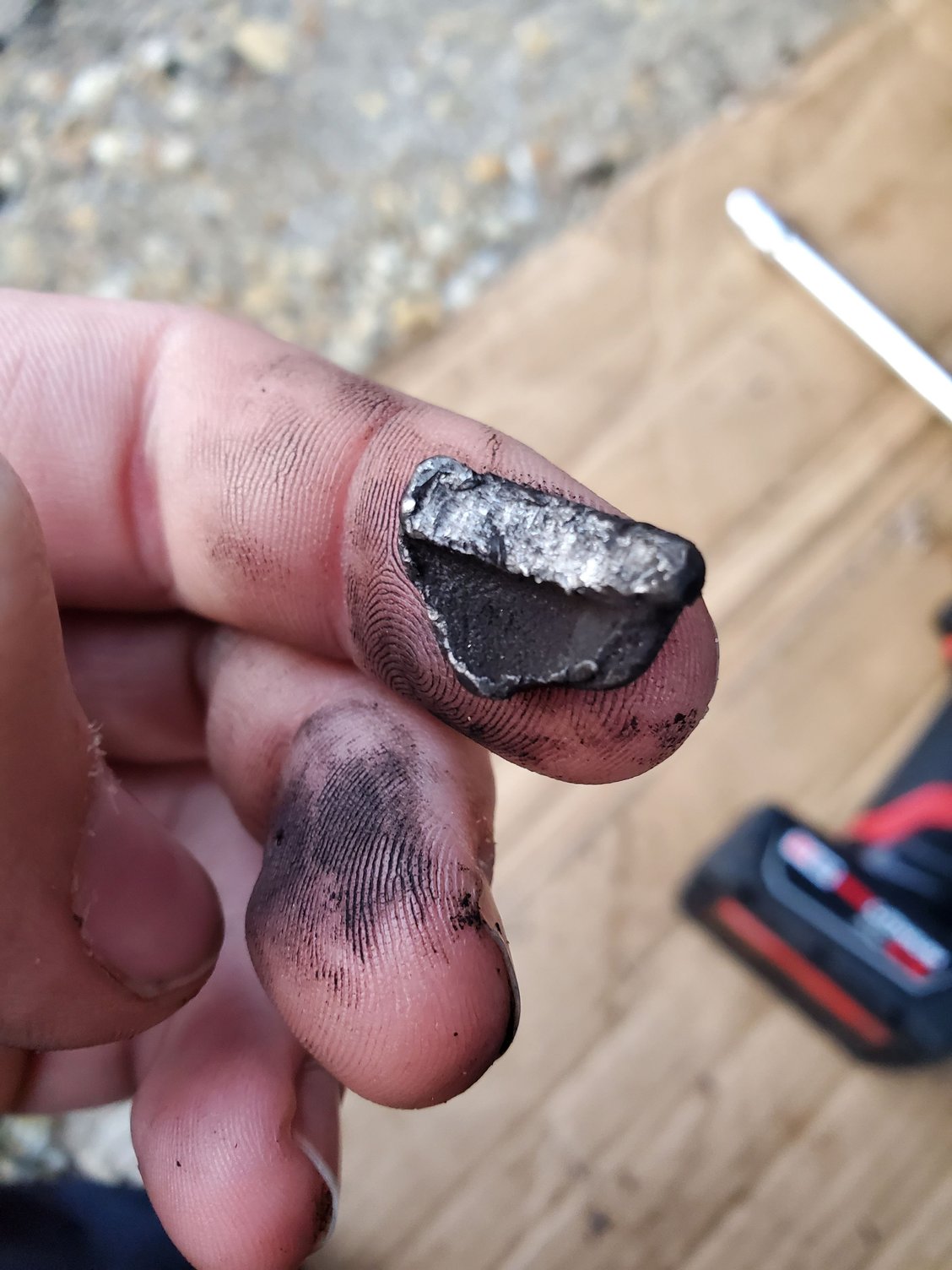

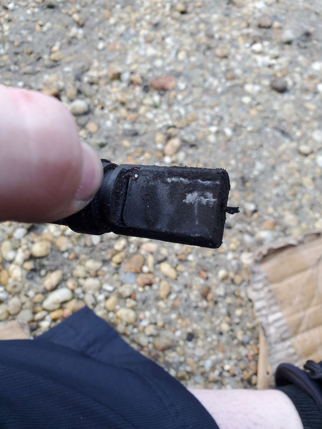

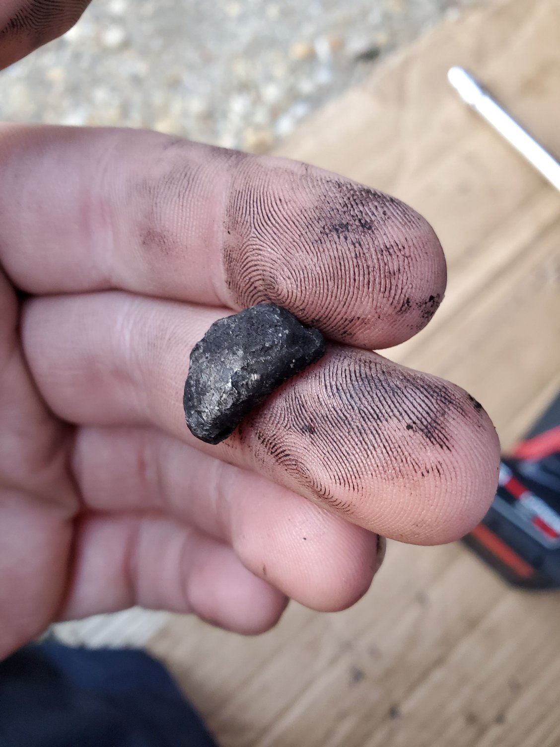

Well, its not the crank sensor either. Grabbed a cheap one from the parts store just to test and it changed nothing. It's definitely getting fuel though, the smell is potent during and right after it cranks. I did the ecu reset as well just in case that did something.
And on a most likely unrelated note: the sensor came out like this and this chunk of metal fell out of the hole... maybe that was my vibration when I would slip the clutch really slow lol

Unfortunately it's time to pull the transmission to find out what's broken inside the bellhousing.
As for the no spark, pull your plugs and see if they're wet after cranking. If they ARE wet then it's some kind of ignition side problem and I would look for wiring problems from the coil packs to the ECU, power from the IPDM, etc. ECM switches the GROUND on/off.
I'm just going to ignore it until it immobilizes the car, kinda like this did. lol

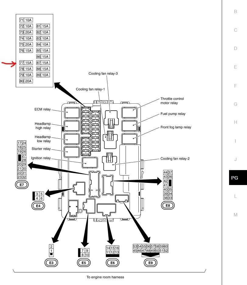

Here a link to the FSM.
https://www.nicoclub.com/infiniti-service-manuals
Check out section EC - Engine Controls, page 665.
I would start by checking fuse 77 in the IPDM

So it's working again? Bad sensor?
What did you ever find out about the chunk of metal?
