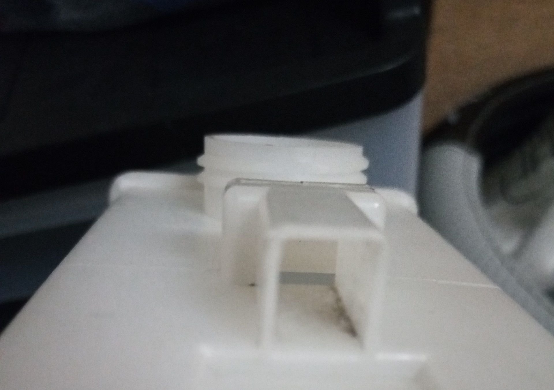

This is the used tank I bought off Ebay, my tank also has this hole at the top, and in Enthusiast Auto Care's coolant service video the coolant tank also has this little vent poking out with nothing attached to it.
The part in focus is the interior of the tank. Water comes right out when you pour.

Thats how my reservoir looks -
I filled in that hole on the top w/ RTV & added a 5/16 barb to the side and ran a hose down to the splash shield. That way, should coolant overheat into the reservoir, the coolant will dump onto the ground and not make a mess all over the engine bay.

Yup, thats just the vent for the overflow tank. Most cars will have a hose connected to it so it can drain out in case it fills up and overflows. Its also there to prevent an air vacuum lock when fluid gets sucked back into the radiator. U are hardly gonna get any dust going in there....definitely not enough to have an impact on anything.
