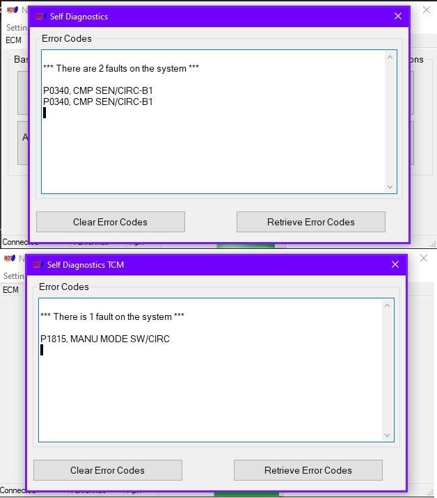

Question P0340 Bank-1
Is it normal for one sensor to go bad more than the other? I just replaced this sensor probably 1 1/2 - 2 years ago. Maybe 2 1/2 years ago.
I have yet to change the driver side. And when I order the sensor last time, I bought a set that came with both cam shaft sensors and the crank shaft sensor; but I only replaced the passenger side.
Thanks in advance for your help ladies and gents
gkey
I pulled the TMC code as well as the EMC, before clearing them.

I'm betting you didn't use an OEM or Hitachi sensor, aftermarket sensors are definitely prone to early failure (if they work at all). It's widely reported that the VQ engines don't play nice with other sensors.
Use only a Genuine Nissan Parts OEM sensor (beware of eBay sellers that show Genuine sensor at a very low price, they are likely a knockoff), or buy Hitachi sensors. Hitachi was the OEM manufacturer for those sensors so that's typically what I use since the part is cheaper than buying from Nissan.

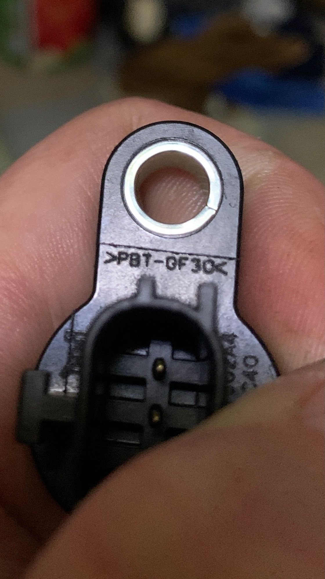

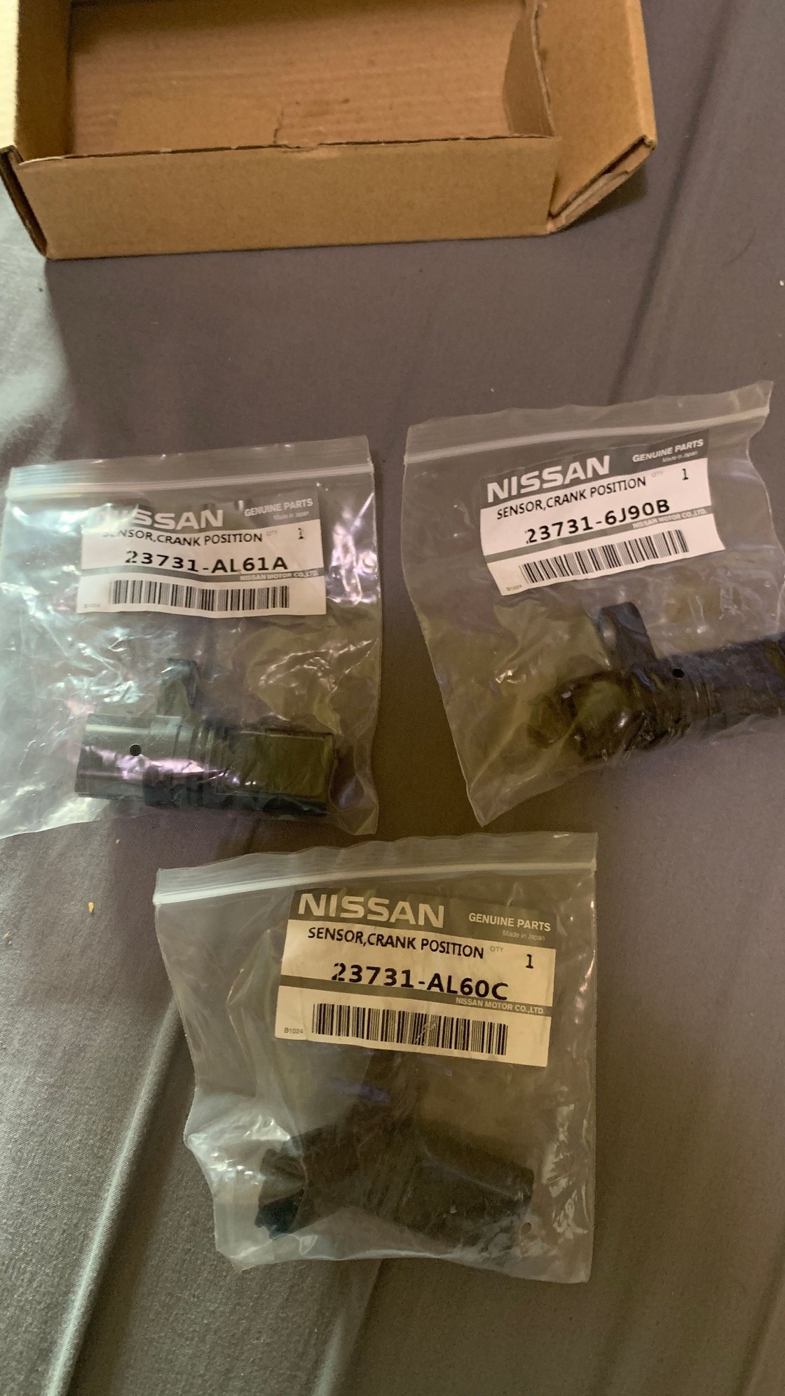

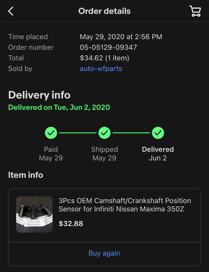

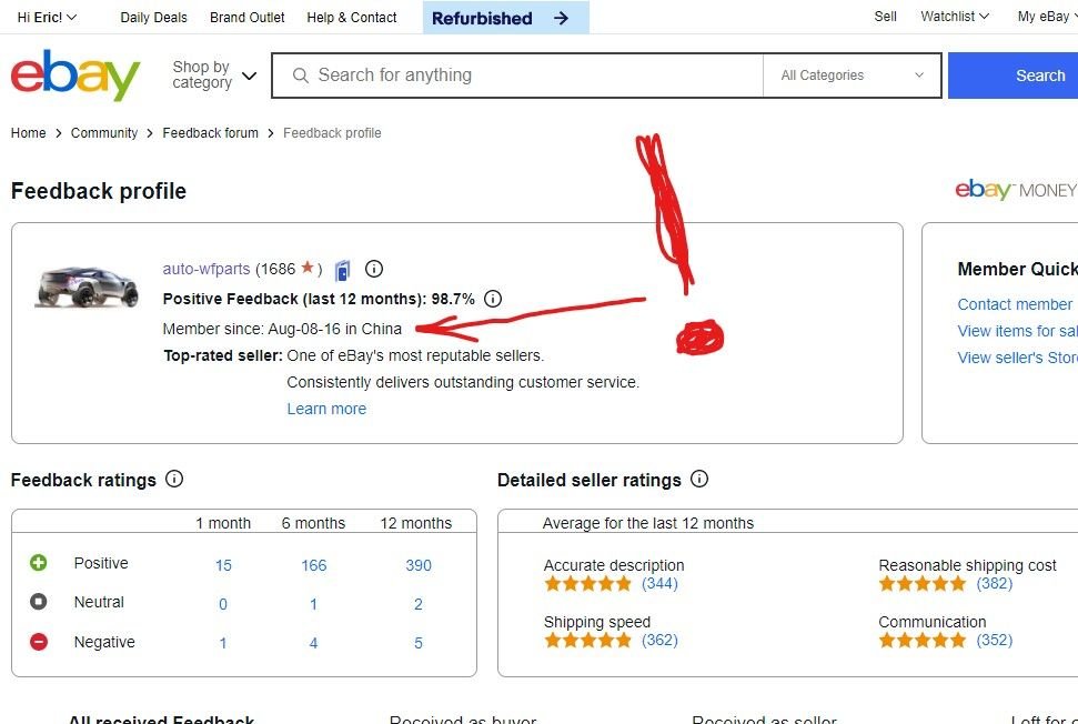

So after looking at my ebay account, I actually installed the sensor last June. Here are some pictures of the ebay account, and the numbers on the left side sensor that I didn't use..
Vender on ebay with parts labelled "Nissan Genuine Parts"
Parts from vendor on ebay
Parts from vender on ebay

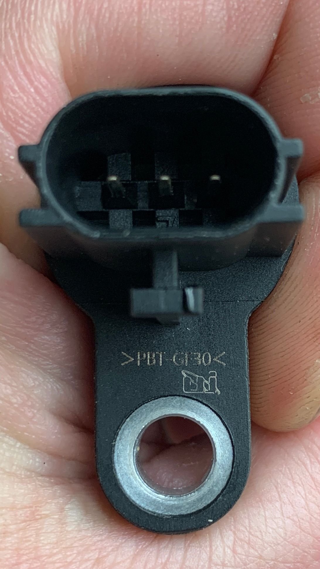

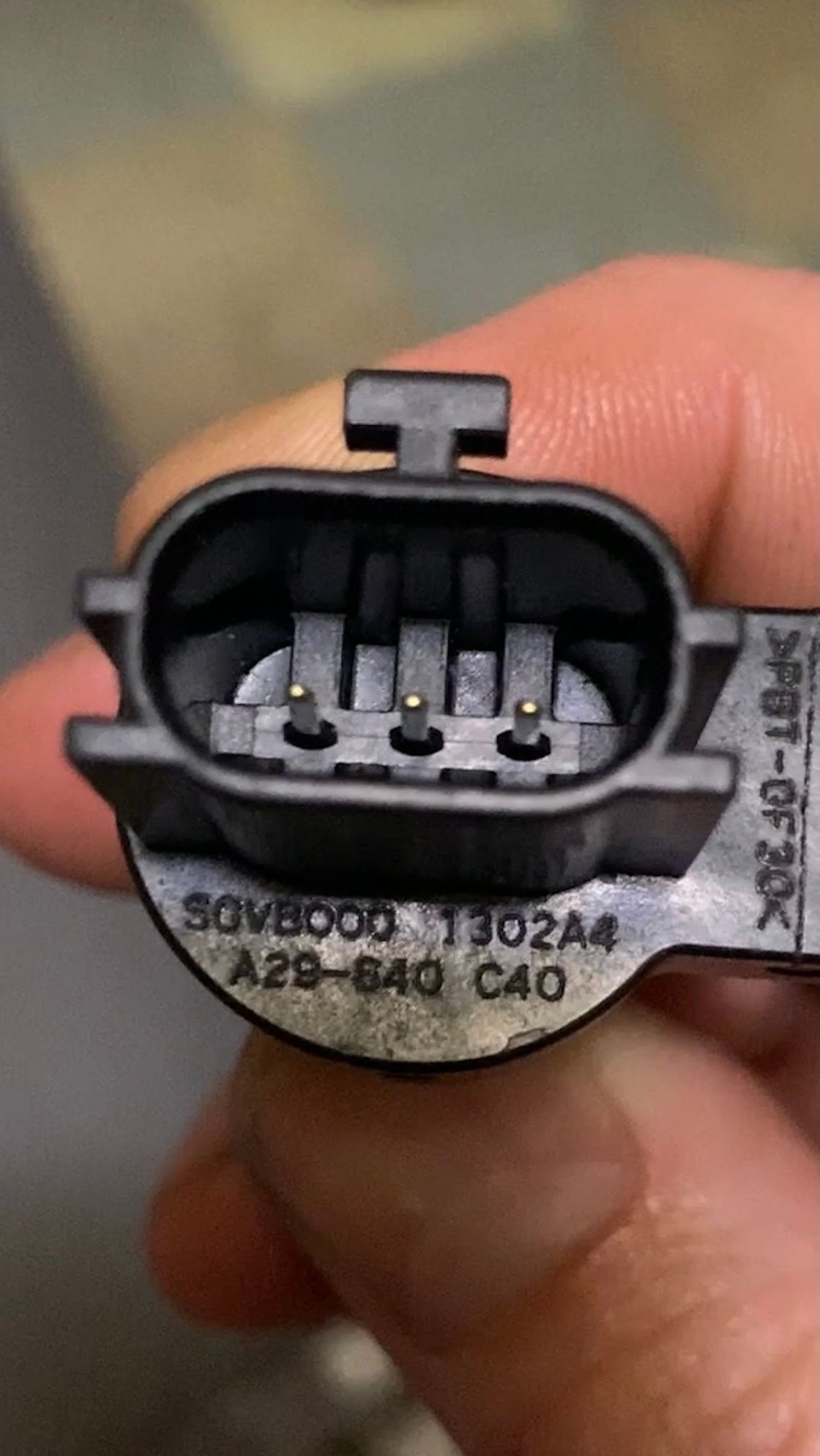

Along with the numbers on the hitachi I got today (before I install it)
Hitachi parts
Hitachi parts

Yep looks like a knockoff, no way you're getting 3 OEM sensors for less than half the cost of a single sensor
Those chinese companies making the knockoffs are VERY good at making them look legitimate. Look where the vendor is from...
