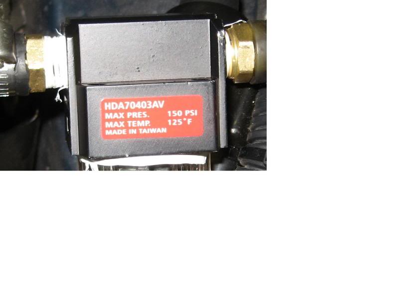

Help, I went to homedepot and all i can see is the HDA70403AV I looked at the sku # on Homedepot.com for the HDA70400AV and it is the same as the HDA70403AV.

Ok, I tried to order this thing online at homedepot.com just to be safe coz there is not much out there anymore, I'm so excited when it came yesterday and for the love of C***** they sent me the same crap I bought form the store (HDA70403AV) I'm going to send this back and just buy an aftermarket Oil Catch Can coz this unit is no where to be found.
this is what the majority of us used:
http://www.homedepot.com/webapp/wcs/...cStoreNum=8125
I have read that some people found the same thing at Walmart too but I searched the website and couldn't find it... I've always seen this one at the Hone Depots near me... you could always order the one linked on line...
Good luck, sorry you're having so much trouble.
