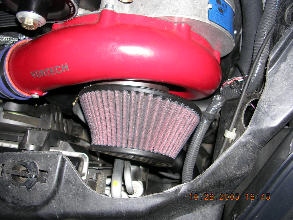

Cool
Originally Posted by Sportcoupe35
That's what I was affraid of....damn...so annoying.
My filter comes right out....no fender well olympics required.
