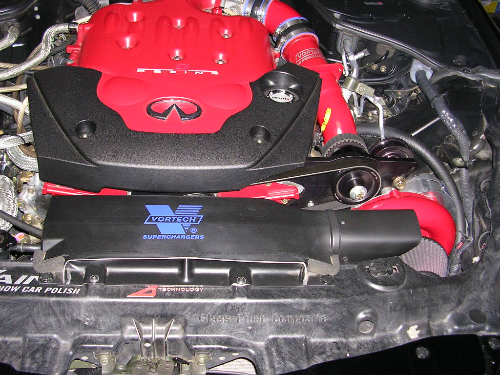

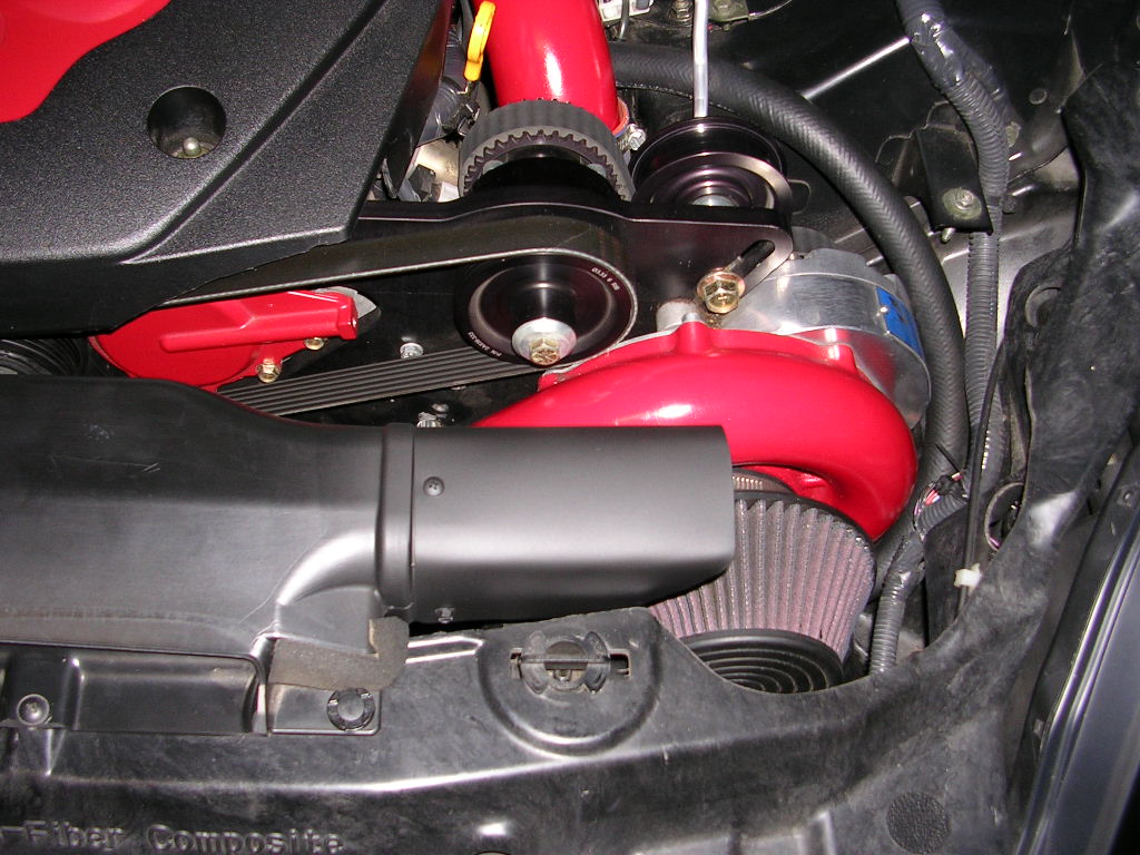

Funny you should ask.......
I just was working on mine this past week and trying to think about how to get more cool air to the filter area.
I put the center intake piece back on and fabricated a diverter / shield out of sheet metal to funnel more air onto the filter. It seems to be working well.
I don't think it would trap any more heat and if anything, your belts would prob slip less if they were warmer. My belt never squeals at all.

Old Sep 1, 2006 | 10:36 AM
thats looks pretty good. Anyway u can make me one
