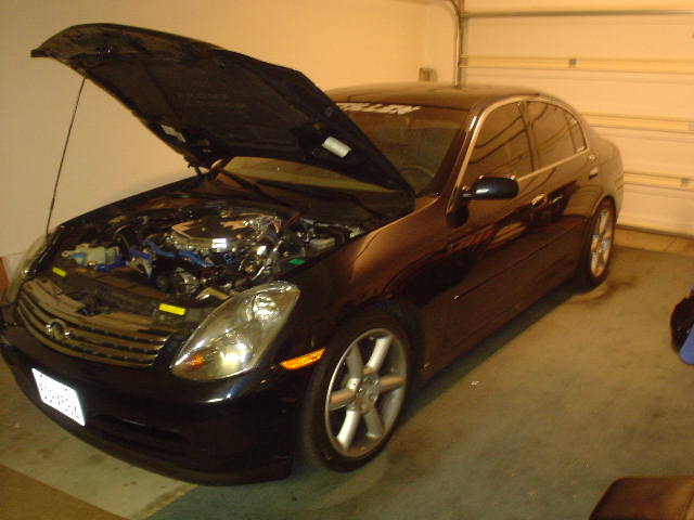

A great tuning place in southern california is Churches Automotive. The guy there really knows what he is doing and very reputable. I have the vortech on my sedan, that Churches tuned very well and safe at 10psi. My car took about 6-7 pulls on the dyno before we had the perfect tune. During the install I had many problems with the fuel system and intercooler piping trying to clear the fan.
