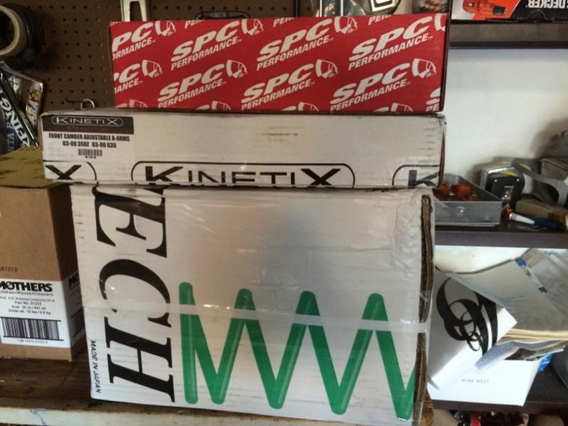

Attached Thumbnails What did you do to the G today?-image-3788851045.jpg   What did you do to the G today?-image-4216618335.jpg

Originally Posted by PLENUMCOUPE
Camber kits?

And springs and New bumper

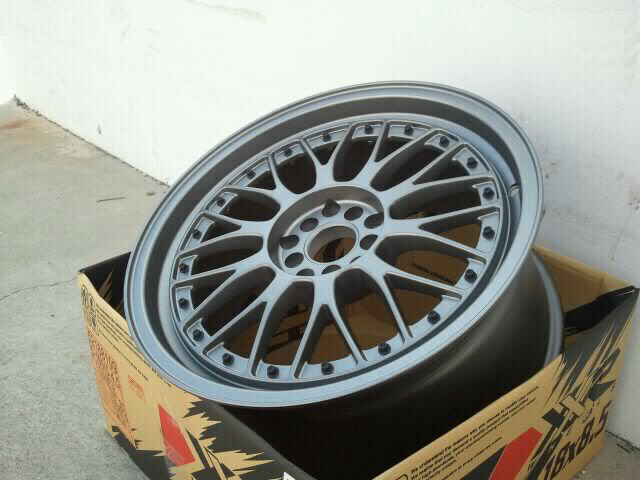

Goin to 20s tho. XXR don't judge me

How low do those springs go?

350z s tech, 1.2" F and 1.1" rear. Not gonna roll the rears with a 285 rear
May wanna consider it. I have stock 18s with stock 245/45 tires and eibach pro (.8" rear) and I ended up having to roll. it would rub on hard corners.

U think so for the front or back ?
For the back. Its easy as fug, tho, man. It seems intimidating, but just go get an $8 wooden baseball bat, jack up the rear until you can fit the bat between the wheel and fender and start applying progressive pressure.
Honesty, if you pick a hot enough day. Park it in the sun and go slow enough, and don't mind sweating a lot you don't even need a heat gun if you go slow enough.
And I just rolled mine to about 45 degrees. You don't need to roll em flat.

I saw the DIY on here with the PVC pipe and hair dryer but I heard a buncha times that the tire fits without even rolling so I'll see how it goes. Have u guys heard the sound of the rears rubbing and is it just the same sound the front makes?
