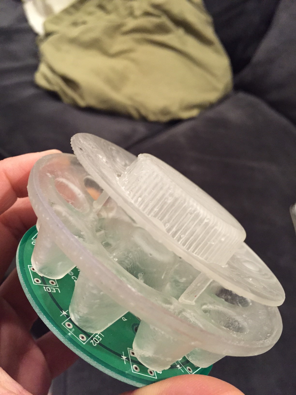

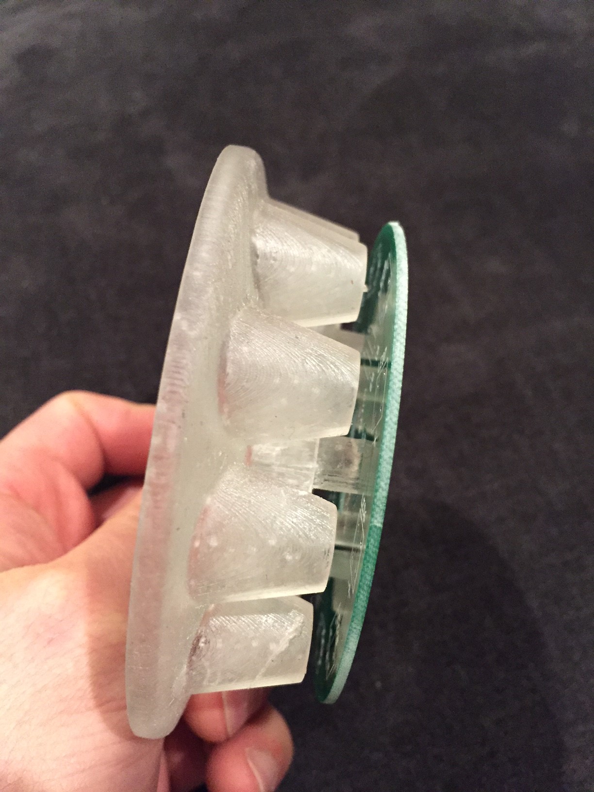

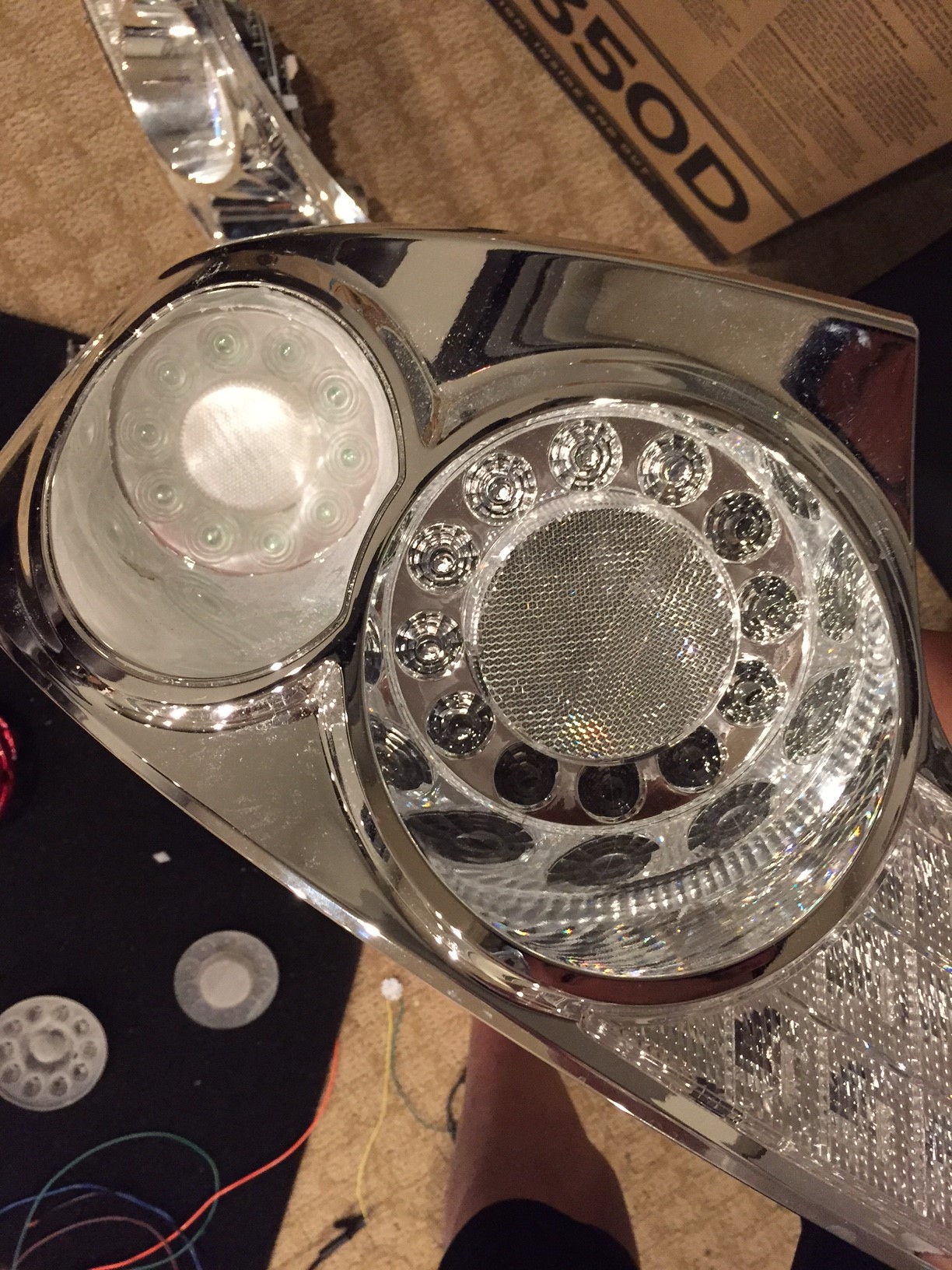

well its going to be pretty much the same as doing a dual ring install. its just this will be much cleaner. i mean you still gotta open up the tail light, and cut off the existing ring but that is pretty much it. the led pcb has holes so the bezel will snap in and then the bezel has holes so the diffuser lens just snaps in.
i know the lens is still not totally clear which bothers me, even though i polished this thing for a long *** time. i just bought a bunch of silicone and resin and am going to try to cast this 3d print in crystal clear resin to get a better result.and then i gotta send the bezel off to get chromed.
lol i wasnt really intending to mass produce these to sell. there was just a minimum order qty on custom pcbs so i tagged em with my name haha. i only have 4 extra sets. buying all the resistors and electrical pieces from digikey now.
edit: showing fitment on the last pic. i still have to trim the edge of the bezel just a bit for a totally flush fit. there isnt very much room on the side of the opening so its gotta come super close. havent gotten around to trimming yet bec i was waiting for these pcbs to come in and get the orientation right first

i have a few extra sets of the pcbs and controller boards. if i can figure out how to resin cast the lens and it comes out good i can probably sell a few.
