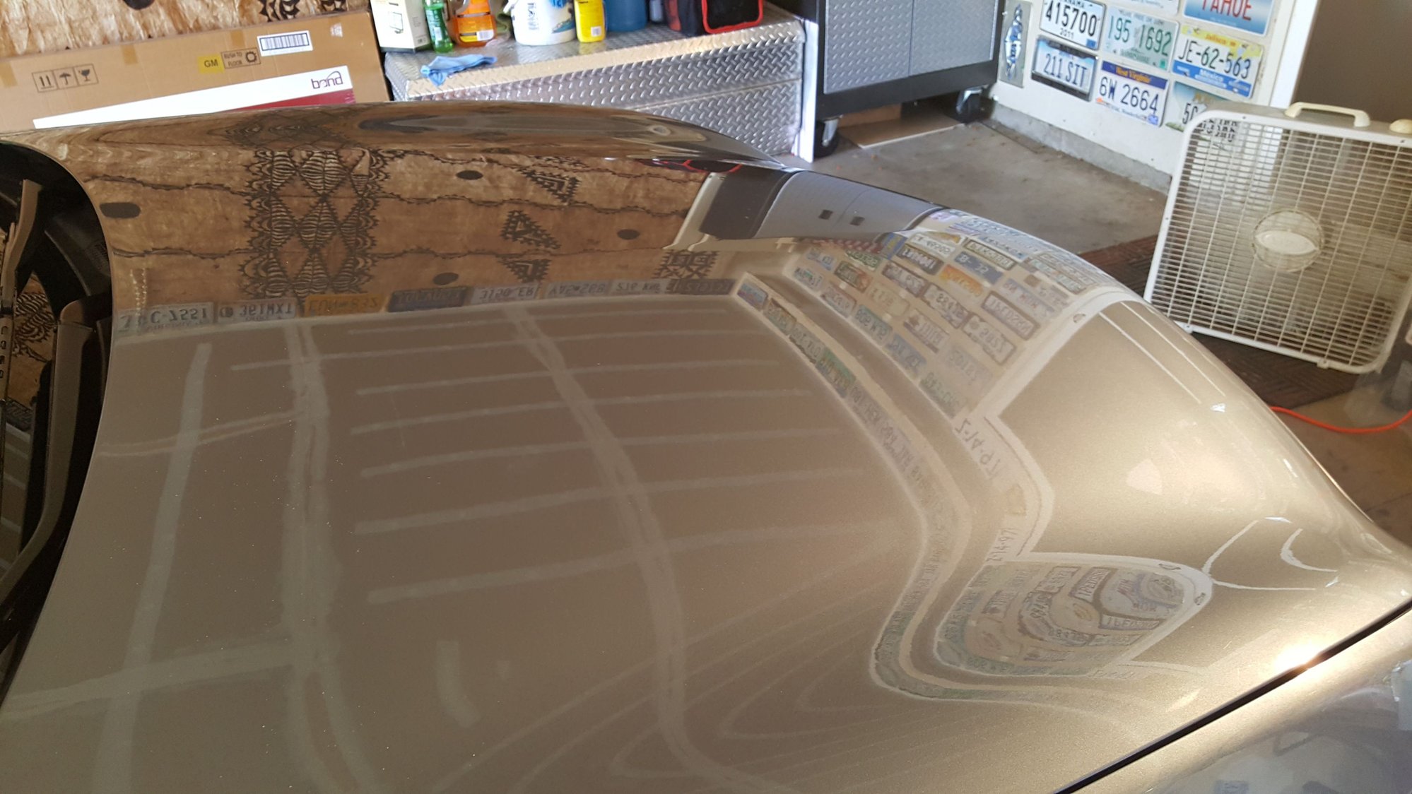

Buffed Out my G35 to a mirror finish
what product did u use?
Old Jun 21, 2016 | 12:31 PM
  #6258
Justindiz's Avatar
Joined: May 2016
Posts: 44
From: Northern California
Simple chemical guys orange pad hex pad and Meguiars ultimate compound, did pretty good.

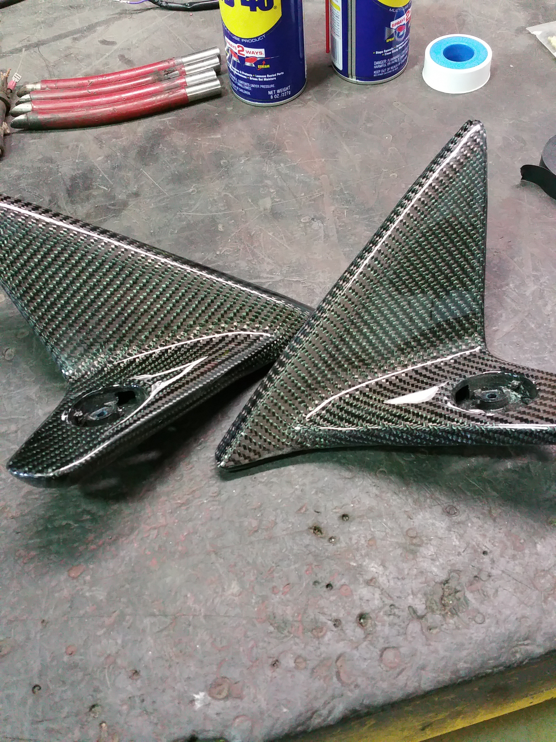

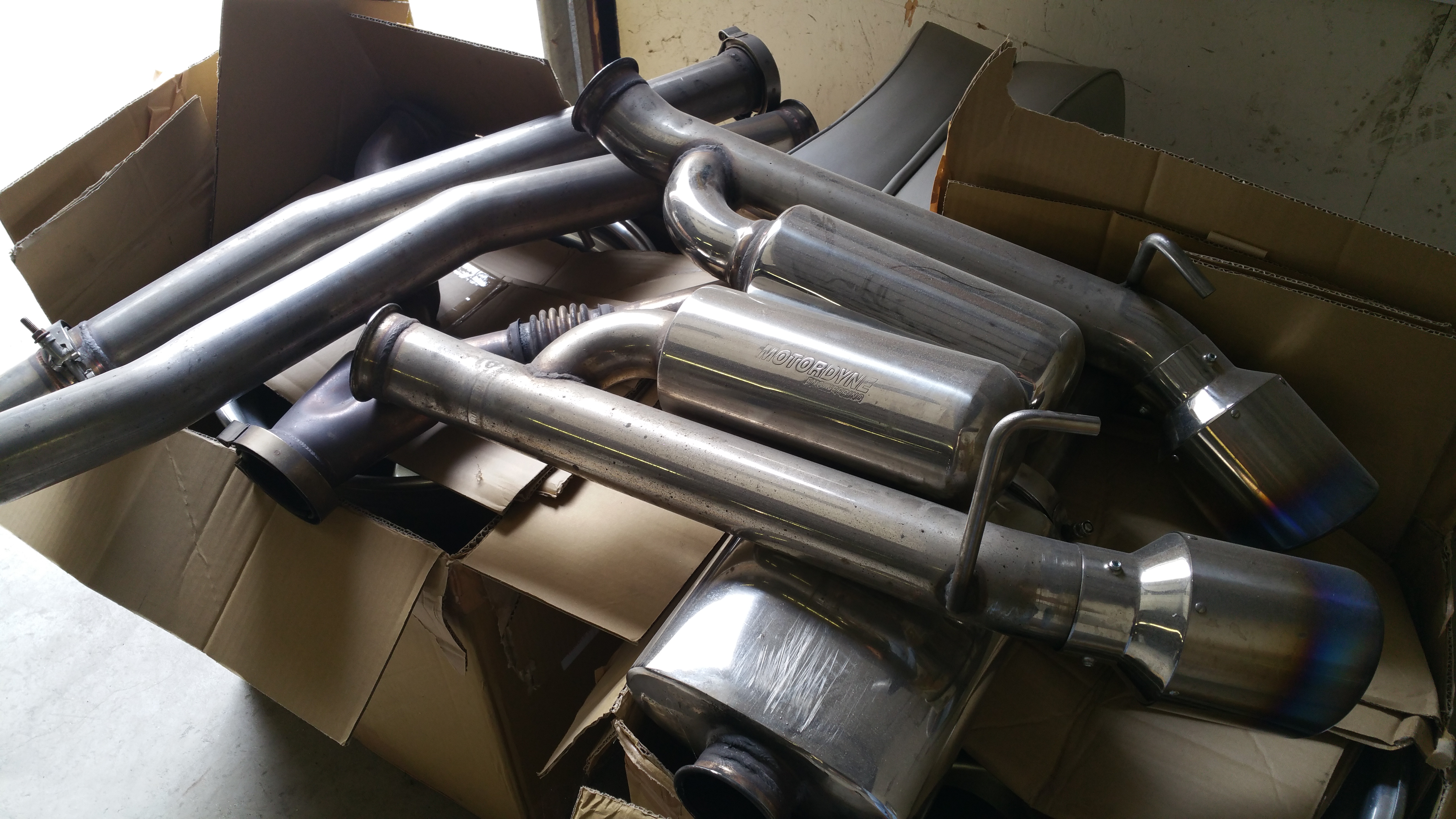

I picked up Shanes exhaust and carbon fiber mirror bases
