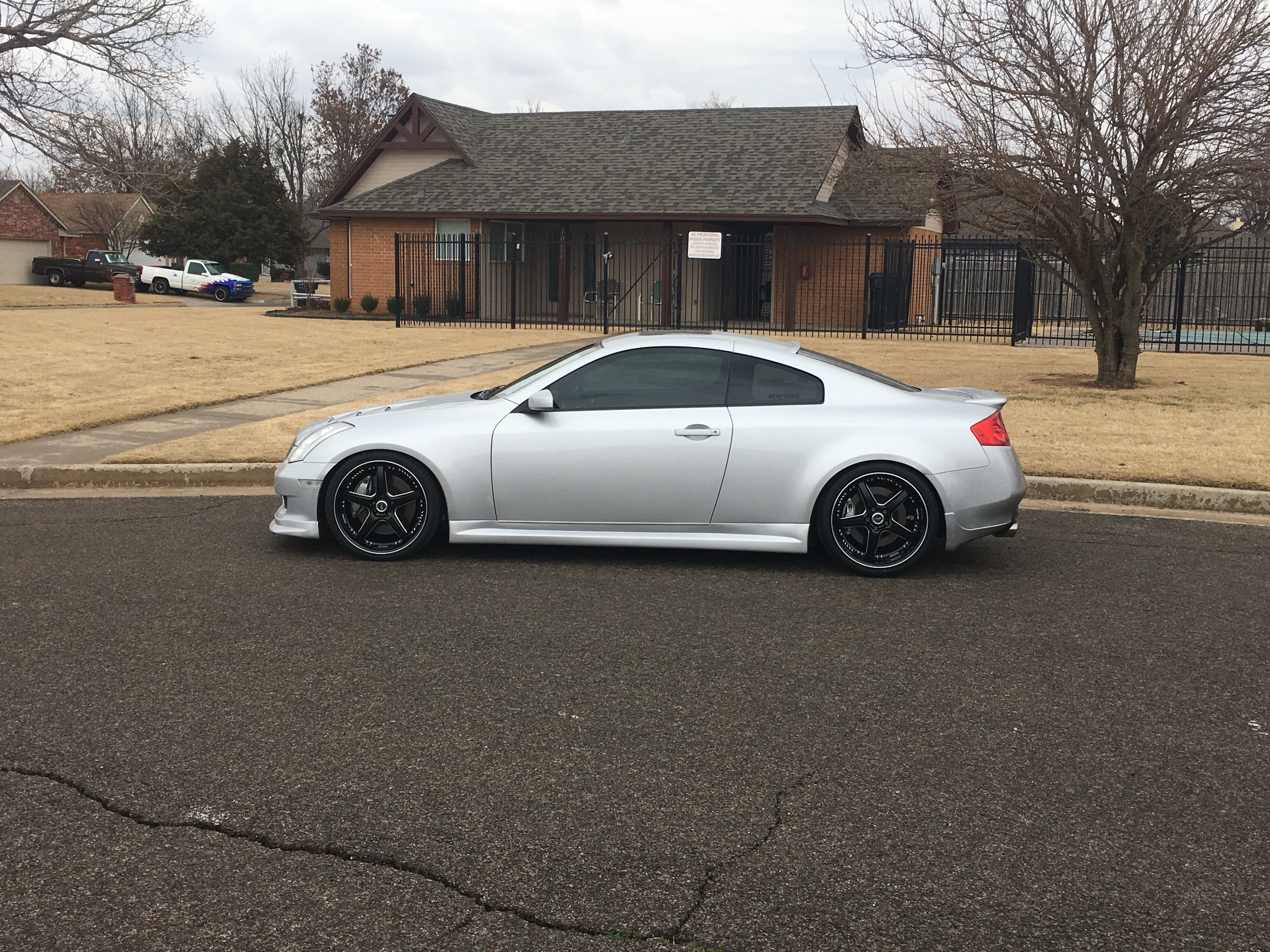

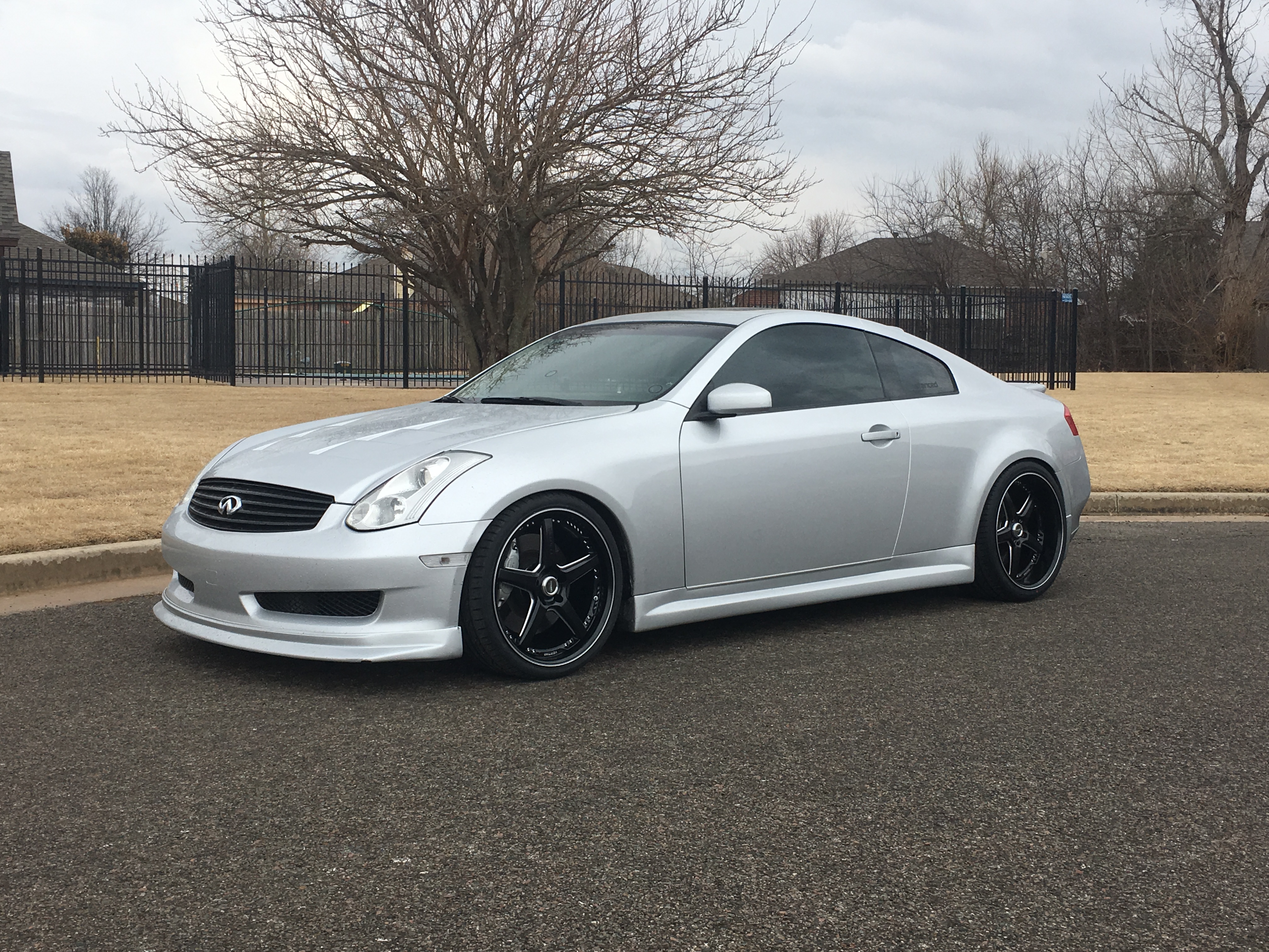

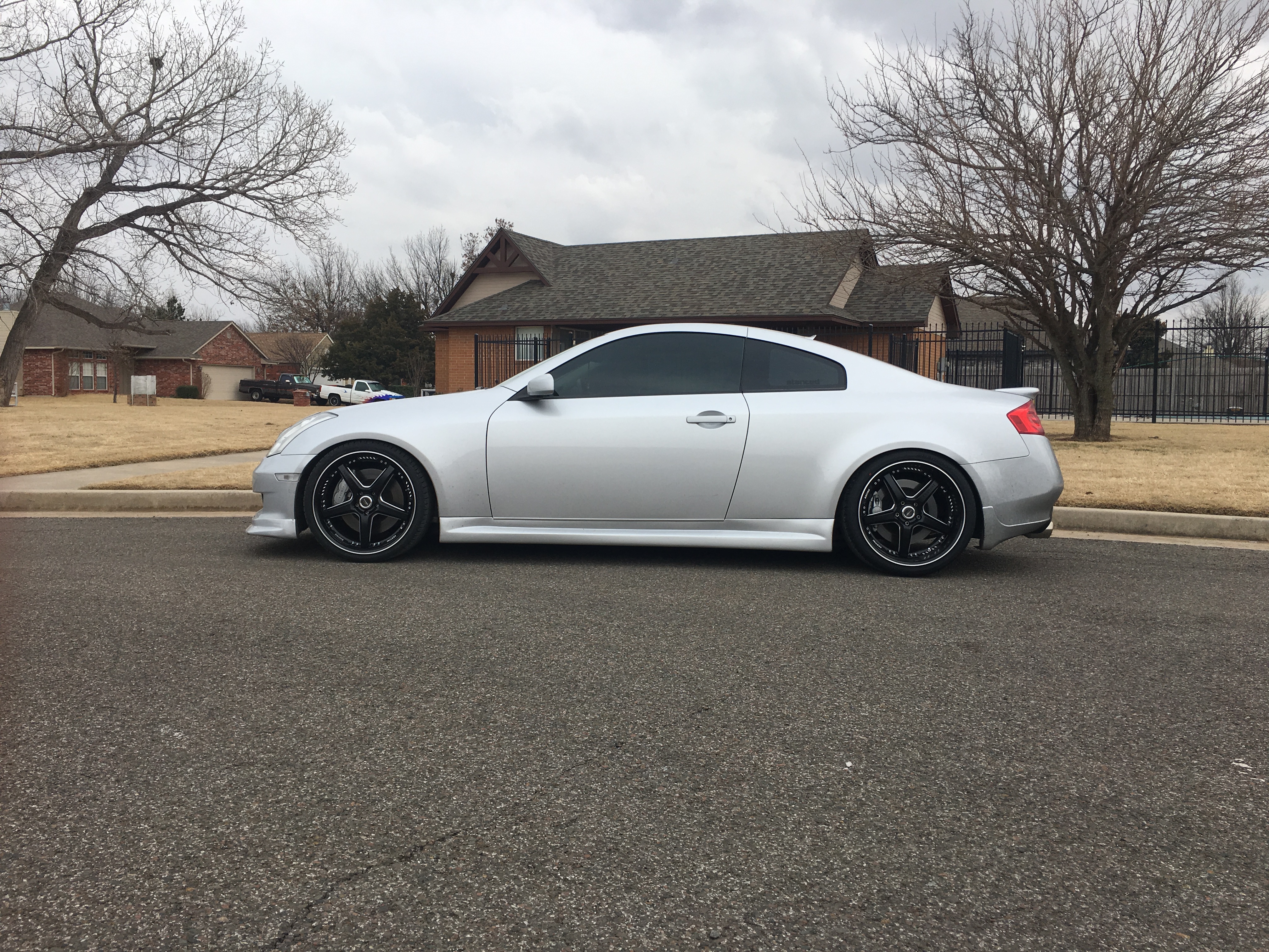

G35
New rims and tires installed. Not sure how I feel about them yet, but either way, they’re on the car. Had to finish in the rain. Lol!
My Nitto’s where shot anyways, so at least some fresh rubber.
Attached Thumbnails What did you do to the G today?-d3539e71-dee6-41ca-90e5-32b422bb9ad9.jpeg   What did you do to the G today?-4df47ff7-041f-4f35-8954-7547d07f654b.jpeg   What did you do to the G today?-32d160ad-68a7-4a01-a680-442b9e239aeb.jpeg   What did you do to the G today?-17c3557d-3855-4c2d-a765-75352b7377a0.jpeg
What are the specs
Old Feb 21, 2018 | 12:03 PM
  #8083
joeb1983's Avatar
Joined: Sep 2011
Posts: 424
Likes: 43
From: Oklahoma
G35
Originally Posted by Mr. Brooks
What are the specs
Fronts are 20x9”, 20 offset w/ 10 mil spacers.
Rears are 20x10.5”, 30 offset w/ 15 mil spacers.
Front: 255/30/20
Rear: 285/30/20
Old Feb 21, 2018 | 12:22 PM

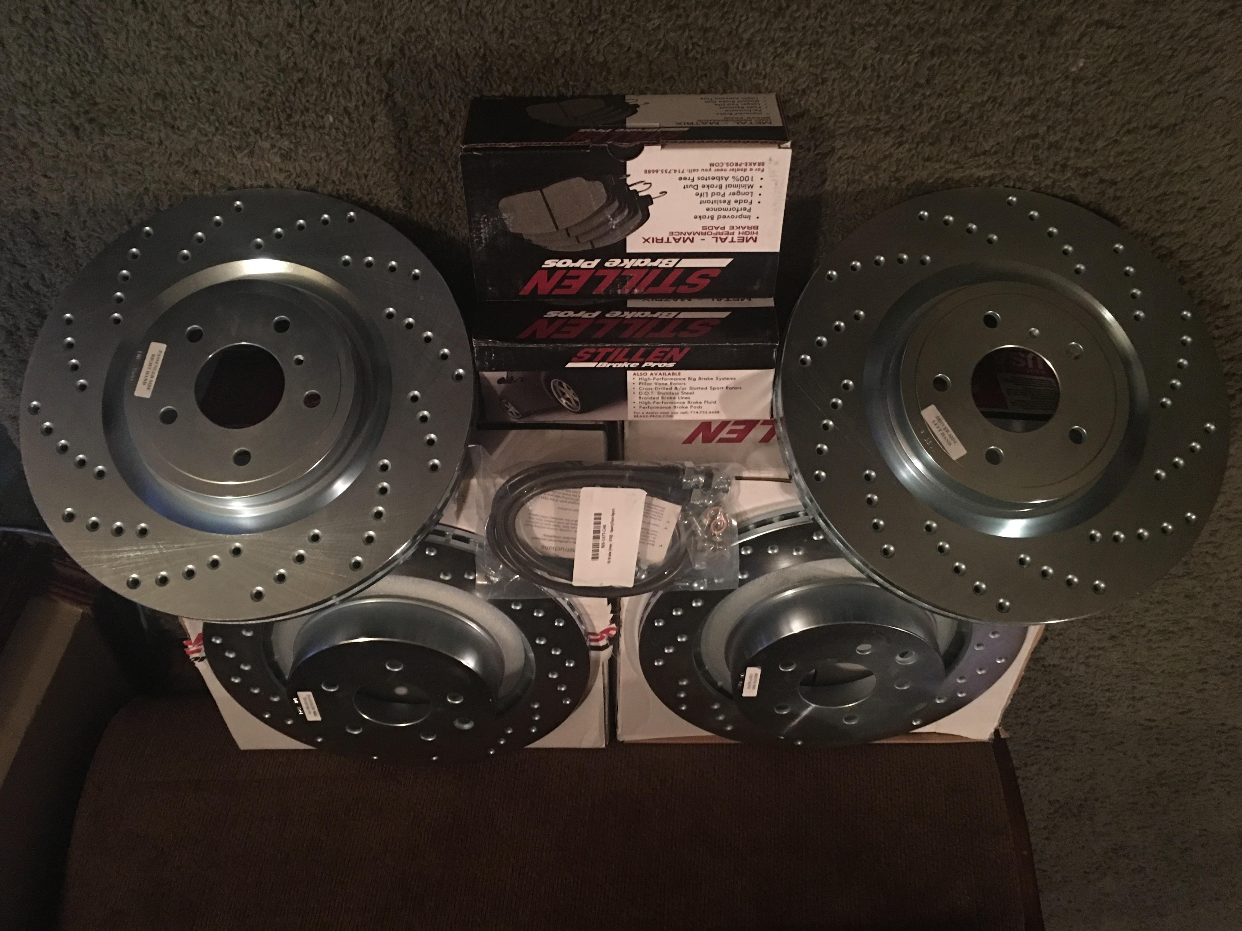

Just received STILLEN’s cross-drilled rotors, their metal matrix pads and Z1’s stainless lines for the Akebono’s. Should look pretty good.
The front rotors are HEAVY, but not enough for two-pieces. Lol!
Will be throwing them on when the weather gets better.
