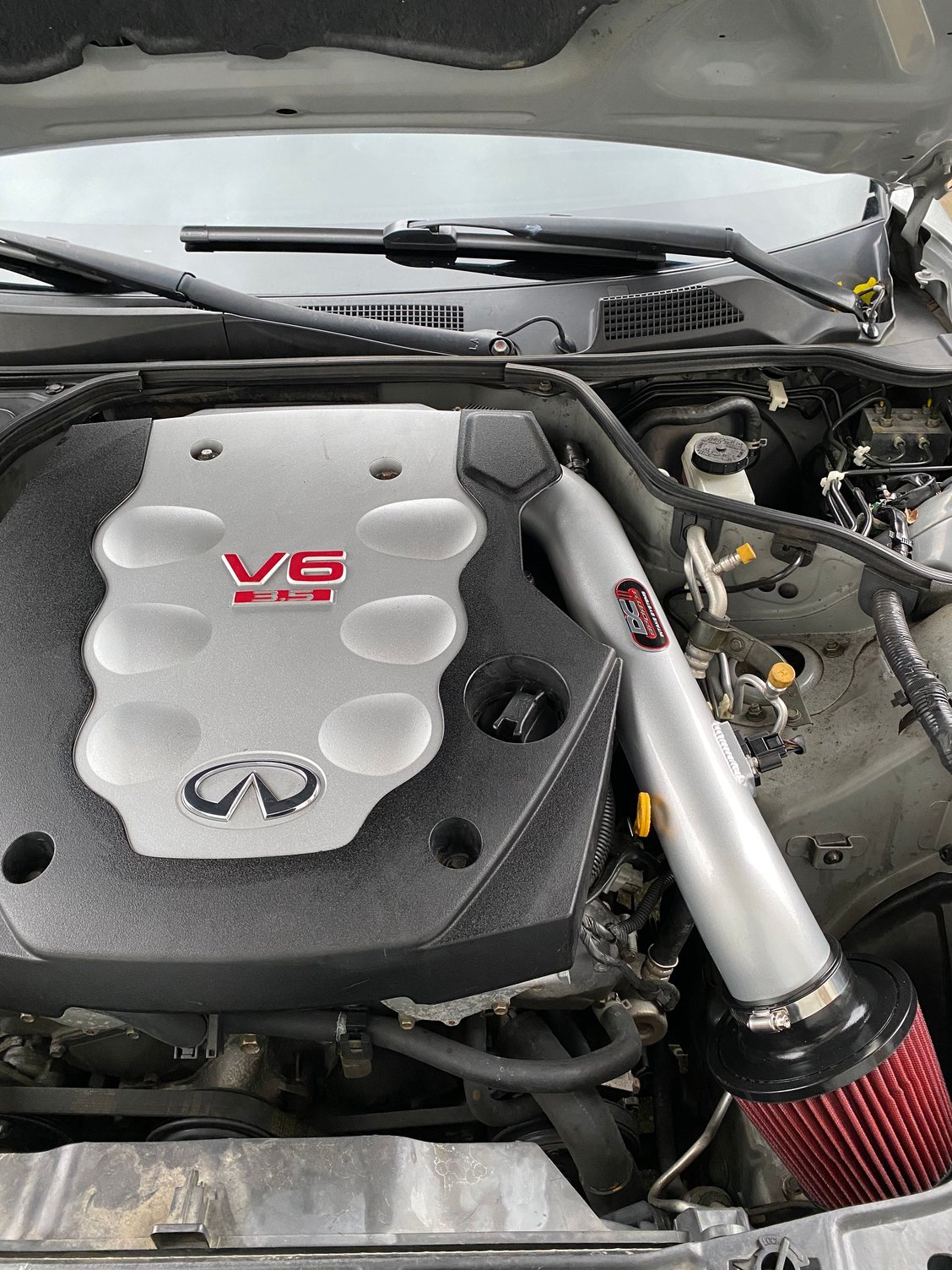

I just installed some test pipes from invidia which I brought from import alliance car show, they sound much better than the cats... A VQ wants to make noice don’t deprive it of doing so. I would just say also make sure to grab a nice intake so it can breath a lil better... IMO if you want a lil extra sound and not to raspy and sounding OD
