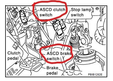

Check the cruise interlock switch on the clutch pedal too if it's a 6MT.
EDIT: Also, make sure the cruise is actually not working, turn it on, hit the set button, see if it works. Just because the light on the dash isn't turning on doesn't mean your cruise control doesn't work. Those dash lights are notorious for misbehaving, my SET light hasn't worked in years.

Next I would inspect the ASCD interlock switch on the brake and clutch pedal, it might just BARELY be closed and even the slightest brake /clutch pedal movement might be opening the switch. If you have a 5AT disregard the clutch pedal stuff.
If that's not it I would just schedule a 1 hour diagnostic at Nissan / Infiniti because they can quickly check all the data to the ECM with the dealership Consult-II/III tool. Otherwise you could spend a LOT of time chasing this issue.

Turns out it was the clutch swtich. The driver before me did a clutch switch override. In the high heat of the summer the electical tape he had on came undone and the the jumper he used had fallen out. Being new to the 35, I did not know that you had to jump the pins do when I looked at the connector the first time I did not realize it had to be jumped. In my second gen Eclipse I did not have to jump the switch, you just diconnect the connector from the clutch. After some searching of the wire bundle I found the gooped up tape with the jumper inside.
I plugged the connector back into the pedal.. all is well.

I recommend fixing the clutch switch, you'll never be able to use your cruise control if it's taped closed since that switch will cancel cruise control.
