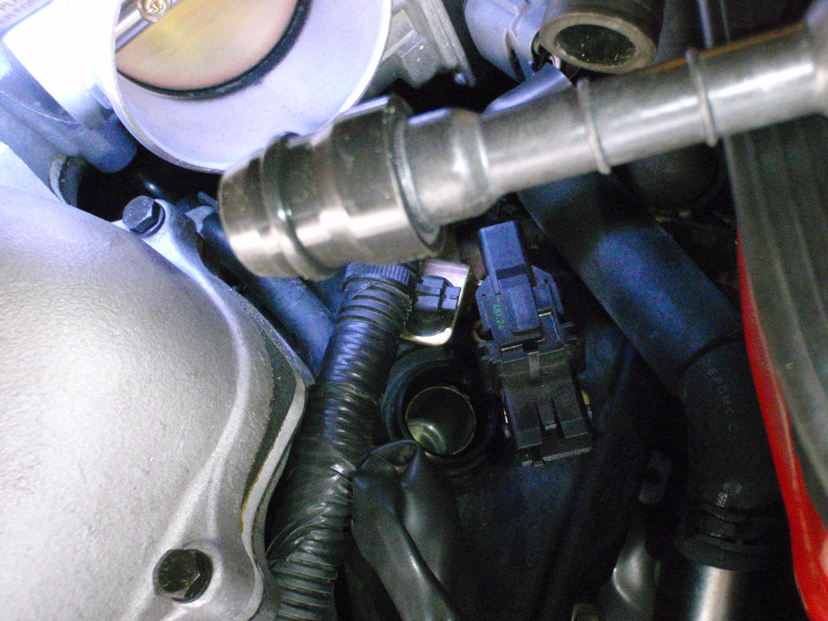

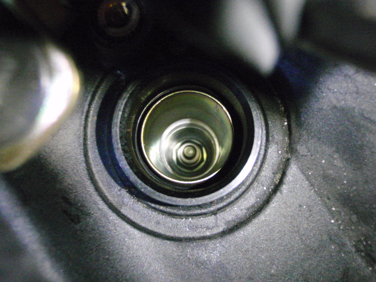

Saw this thread and got alarmed since my warranty will be up this July, so decided to check all my plugs this morning. To my surprise all of them were completely dry
As soon as I get some time I will be making the makeshift catch can, since I know there is oil on the intake manifold already.
Here are a couple of pics of #6
