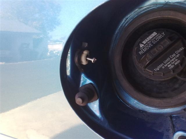

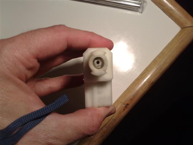

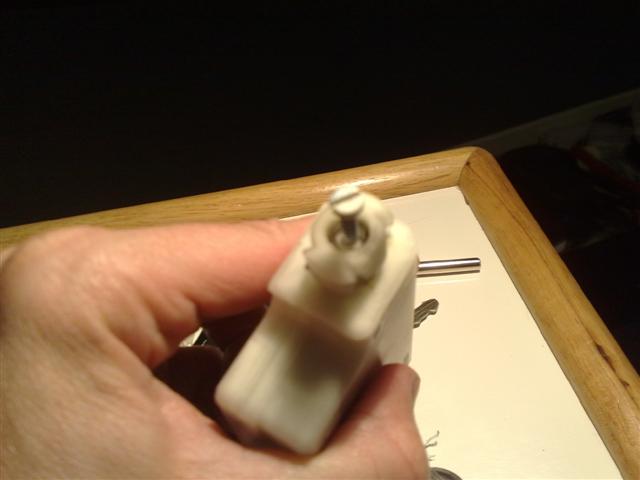

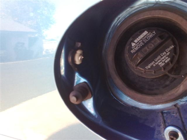

I found out today that the gas door lock was broken, I looks like he tried to close the door while the lock was engaged and broke off the plastic pin that locks it.
Here are some pics of my rigging, I know it does not look great, but who is going to see it.
I drilled a small hole in the old left over part of the pin.
I grabbed a flat screw I had laying around and screwed it in. It seems pretty solid and works great, plus nobody is going to see it. I know there has to be some better ways to fix this besides buying a new part. I don’t know how much a new one cost but I am guessing about $50?

Yeah my gas door lock is broken too. How'd you get that whole part out? It looks alot larger than I thought.

is that rust on your gas tank?

The part was pretty easy to get out,
1. remove the black clip on the inside, picture 3 and 4
2.remove about 8 of those black plugs in the trunk, you don't need to remove the panels just take enough plugs out to get your hand behind it and pull that solenoid out.
3. remove the electrical connector.
That is just dust and dirt, the guy who owned it before me let the whole car get pretty dirty.
