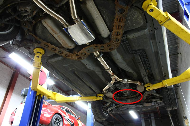

So I finally figured out why my car sound like it's knocking and rattling everytime I step on the gas. The bracket that supports the exhaust was broken on one side. It is also supported by a rubber mount under the transmission. Everytime I would accelerate, the exhaust would hit the bottom of the car and that broken bracket would bang against the exhause. I thought I was having rod knock or some serious problem with the engine. A$20 welding job fixed that problem.
I must have bottom out the car one too many time to break that bracket.

hahaha..sorry that's not my exhaust, or picture. Just a random picture I found online so I can show the location of the bracket.
