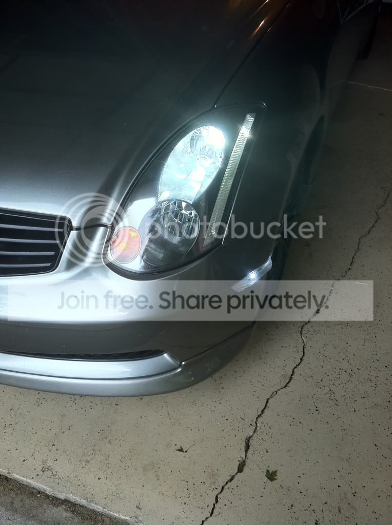

Update. I sourced the pigtails and plugs from Speck's partout (thanks again!) and some new jdm bump clears and LEDs from Bl4ckL4v3nd3r (thanks bro!). Installed today by using the above method. Spliced into the wiring for the clearance strip instead of the turn signal because the signal had 3 wires coming from it, and the oem wiring for the sidemarkers only has two wires, and is identical to the clearance strip wiring. So I hooked it up today and it looks great, changed the headlights to 6000k also.
