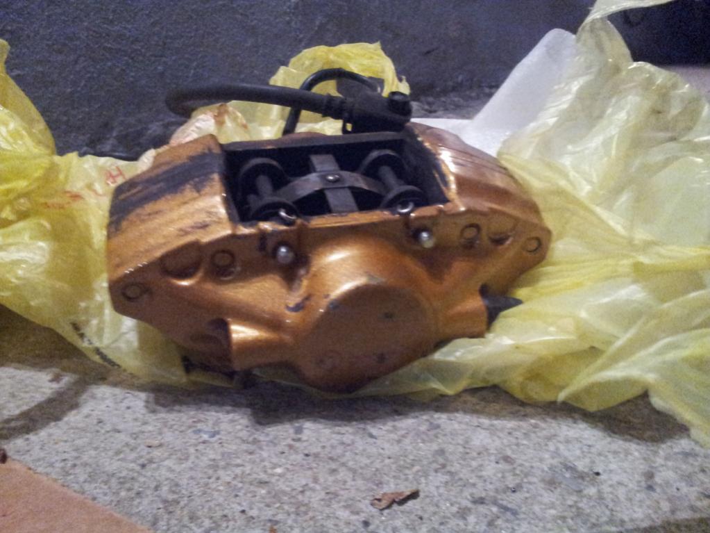

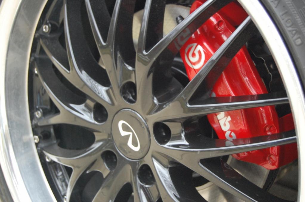

^ second gary's advice. I just went through a brembo swap last week. Buy the seal rebuild kits, clean and have the calipers painted/powdercoated, and then install the new seals. Buy some quality SS lines, rotors (use your vendor of choice, but I went through Charles at B2autodesigns) and brake pads if the ones you get don't make you happy. One thing to remember, you will need 4 bolts that need to be ordered from Nissan since the OEM rear bolts do not work, the part number if I remember right is 080412351A.
Aside from that, install will take a few hours at most, and most of that time is taking the old brakes off and bleeding the brakes. There is an excellent thread on my350z with pics of the swap process. Just take your time and have a friend help which makes it significantly faster. Here's mine before and after:
Attached Thumbnails Couple questions about upgrading my 05 coupe-20130131_191601_zpsbc7cc37e.jpg   Couple questions about upgrading my 05 coupe-dsc_0670-1024x681-.jpg

Who made your center caps?

I did, everyone has their own way but this is my procedure:
(1) set of brushed alum logo cutouts (eBay, was like $5 shipped)
Take original centercaps, tape off edges, sand then bondo surface flat and smooth
-heavy coat of black paint, let dry 10 minutes, and carefully lay cutouts on paint. This will allow a stronger bond since paint is not completely dried.
-put in toaster oven, 30 mins at 150F, take out, dry overnight
-next day coat with clear wheel coating paint of you choice, 5-6 heavy coats to completely seal in the cutout and black paint
-toaster oven again for 45 mins at 150F, dry overnight
-install, sit back on the couch and crack open a cold one.
