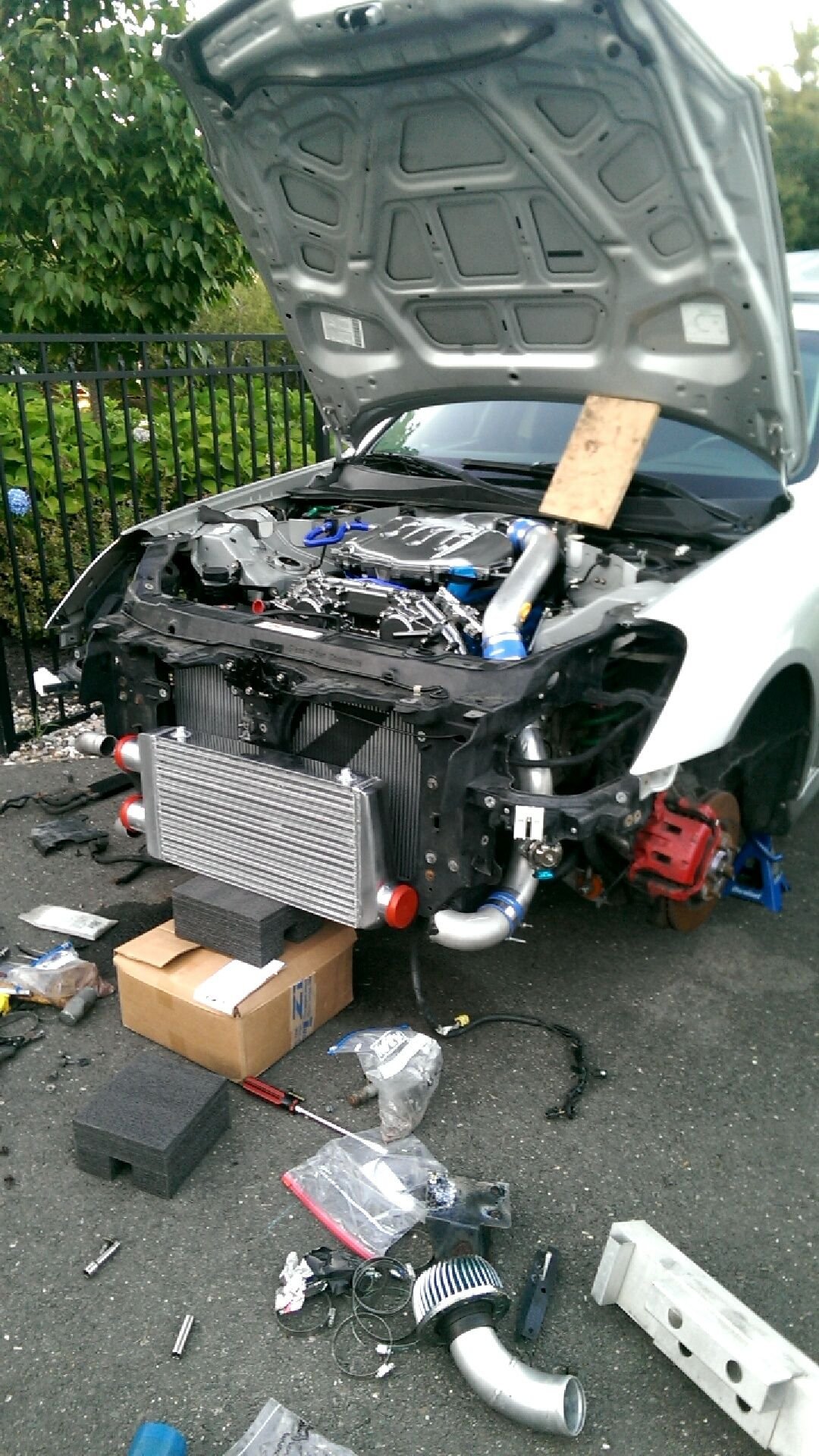

Wow do u really have the hood propped using a piece of wood?
MDF... Gets it higher and more out of the way... Why the heck does that matter? Didn't want to take it off alone for the 4th time this year, I told myself the hood and front end are staying on from now on so I can get wiring and other little things finalized.
