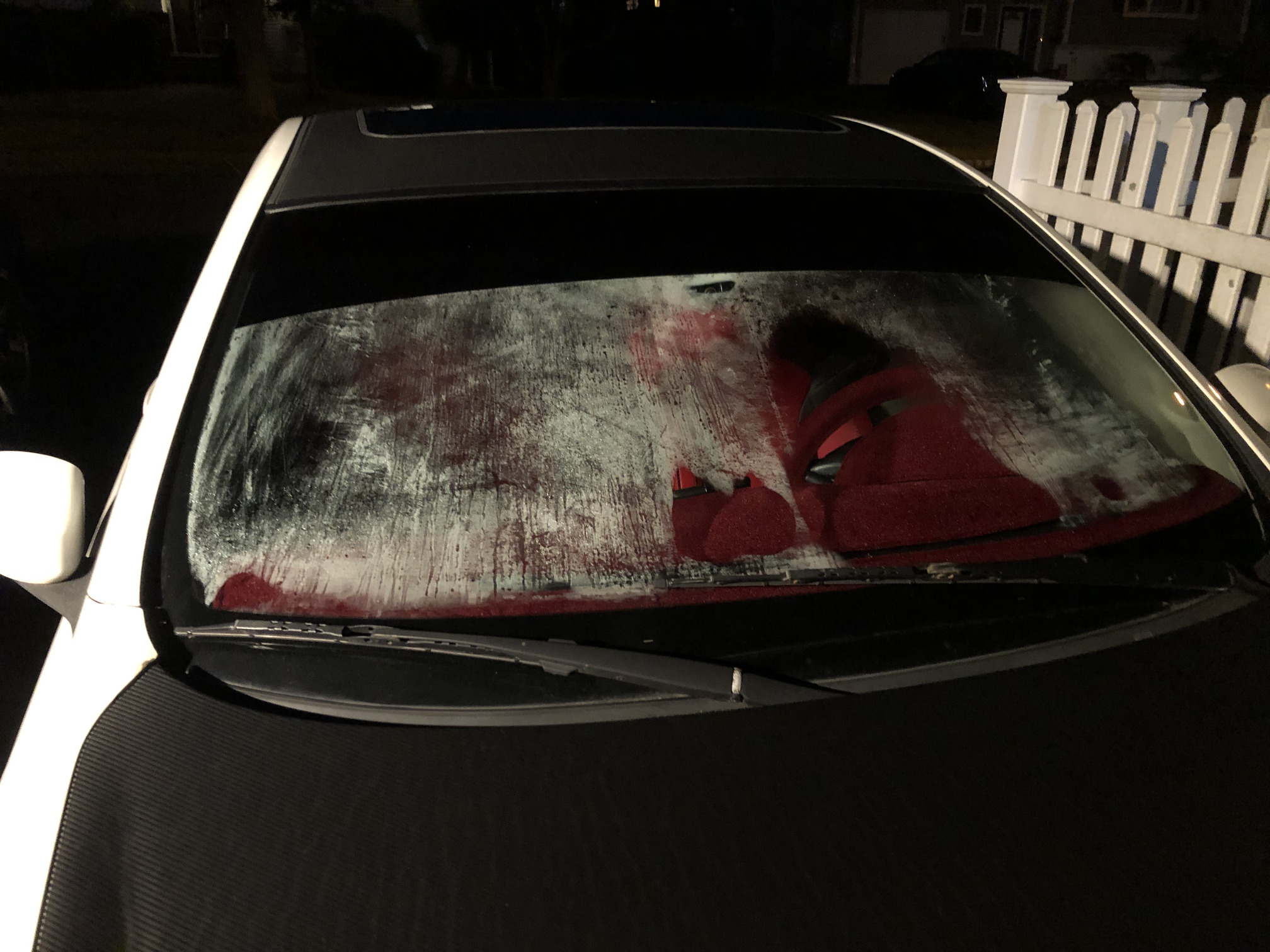

Is there a leak ?
Hi
On mornings or nights I see this frosting on my windshield (see image at https://vkmotorsports.com/blog/image.../frosting.jpeg )is this due to a weatherstrip leak or something ? 2005 6MT Coupe with 187,000+ miles.
How do I figure out if this is a leak or not ? there shouldn't be anything really, since my other cars don't have this at the same time this car has this kind of frosting.
Please advise.
frosting
Last edited by vkmotorsports; Feb 5, 2024 at 09:32 AM. Reason: Image not showing up so loading it via URL

You're getting that because high humidity in the cabin is condensing on the cold windshield (radiant cooling to the sky at night). So yes, it's an indicator of a potential leak somewhere. Check the usual culprits: clogged sunroof drain(s); misaligned windshield cowl above the battery allowing water into the cabin through the cabin air filter; bad grommet through the firewall. If the leaks are significant, you could have water pooled in the floor pan wells (they have styrofoam blocks in them to level the carpet. If that's the issue, you can't just dry the carpet; you have to pull the carpet and dry out the wells).

Originally Posted by vkmotorsports
Hi
Please advise.
frosting
Is that inside or outside the car?

I had the same problem in my van, was leaking on a roof rack nutsert into the back of my van cabin. Definitely would check your sunroof drains they are the most common failure this platform.

The red interior lights make it look like you hit a deer or something 🤣
This maybe the real problem. i do see water in my wells after heavy rains. i vacuum it out each time.
The interior has been changed to red, not using red lights. the lighting is from the driveway lights or the camera flash.
Red Aftermarket seats with Red center console
Also added a dash cover that's red to cover the cracked/damaged dash. Hides a lot of blemishes of the interior.
