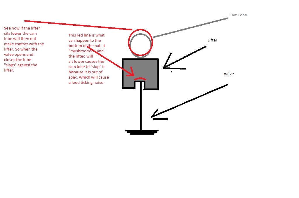

Hopefully it isn't ticking coming from the valve lifters (or hats, whatever you want to call them). Nissan uses a hat that sits on top of the valve, and the piece that contacts the valve sometimes can "mushroom". If so, it doesn't need to be replaced (won't harm the engine), but it is annoying as hell for sure. I attached a picture of what the lifter (hat) looks like.
Does it increase when you accelerate?
Side note, white smoke isn't good.
