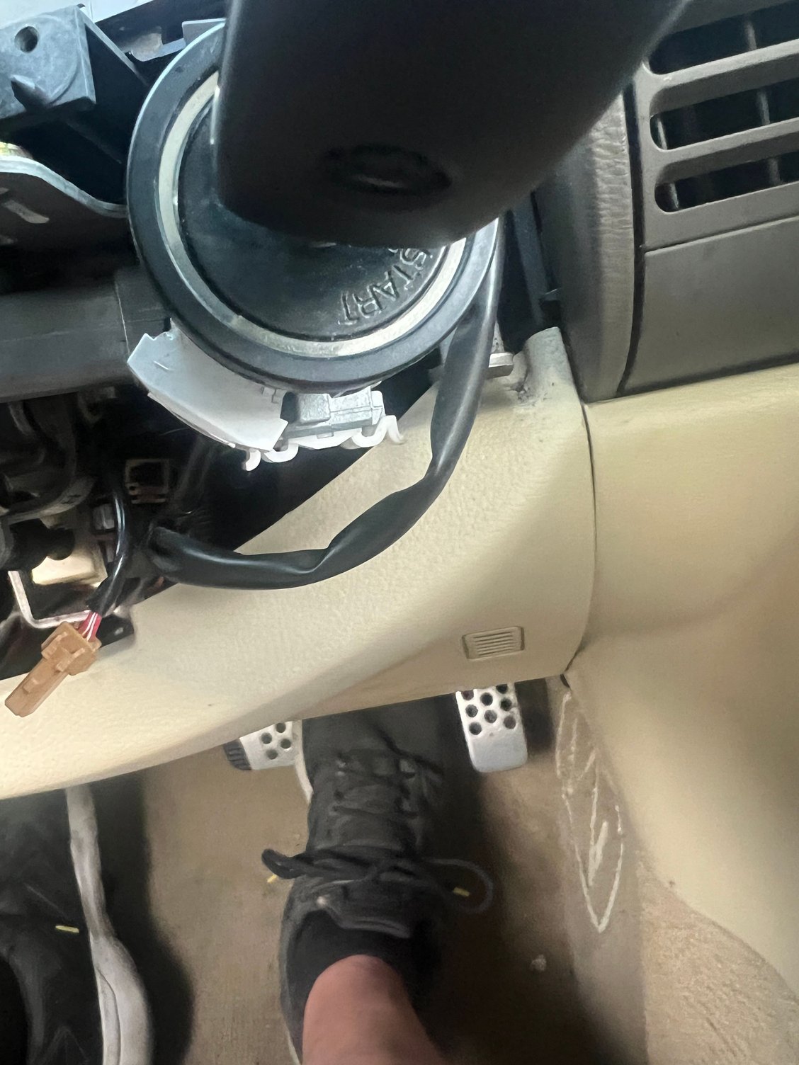

How to temporarily bypass the VATS if you have an original key
If you take apart the plastics to see the ignition, you will see a white or off white part at about the 7 o'clock position. This is where the chip from your key needs to be placed to use a non-OEM key. I have a VW style switch blade key, like the OP, and that worked for me. I did go to a local lock shop and got 2 more identical key chips so now I have 2 new keys/fobs and the single key and fob that came with my 2005 Coupe.
White sensor for VATS around the 7 oclock position on the ignition.
White sensor for VATS around the 7 o'clock position on the ignition.
