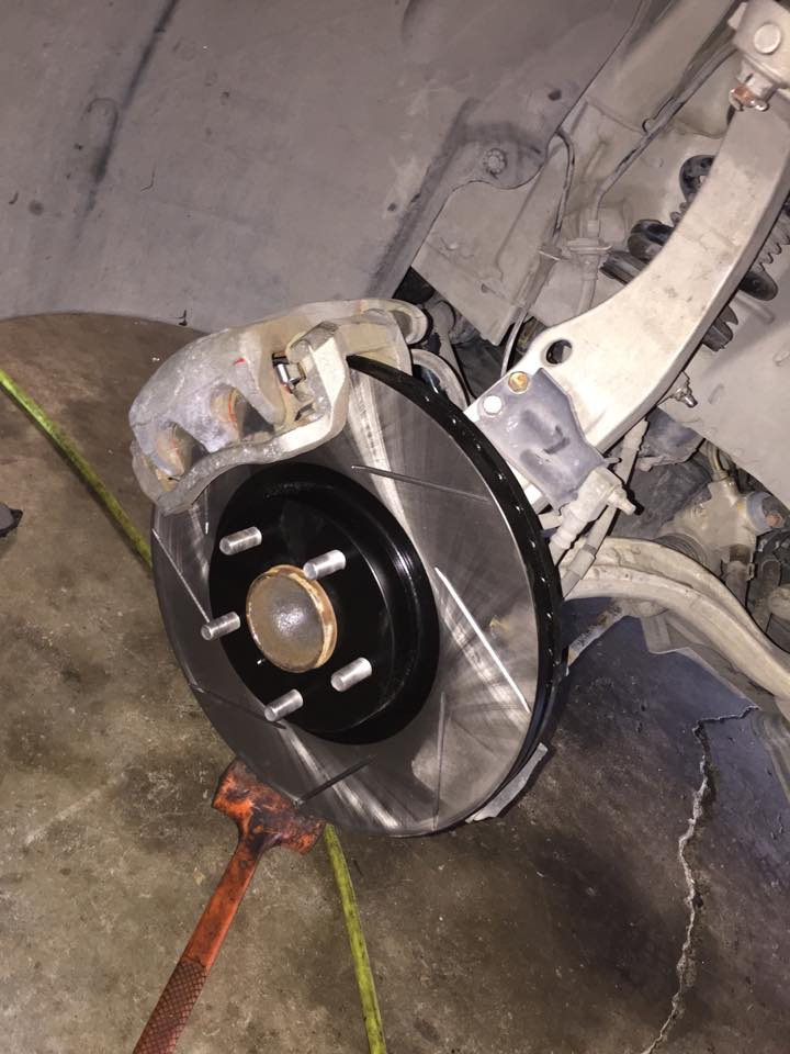

I went with Stoptech Pads on R1 Premium slotted rotors aka centric premium slotted blanks. This is the most dust I have seen out of any pads. I have used ebc, oem, akebono, posiquiet and other random pads on vehicles when I bought them. The grab and respond extremely well to repeated braking. They make my wheels look graphite ...lol but they work. I did stainless lines along with stoptech fluid flush. All that really makes a big difference and I have a lot of confidence in the vehicle.
Attached Thumbnails Need brake advice-12088389_10103460741553140_1282830613735314071_n.jpg   Need brake advice-12038178_10103420985135320_733709727224393301_n.jpg
